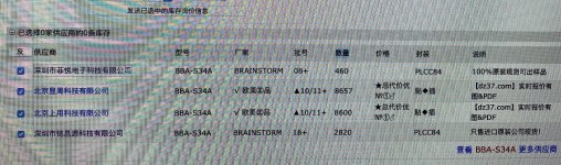

@quorten Sorry about my meandering mind.  You see, I am not proficient in the skills to do much more than offer manual labor, funds, other knowledge, et cetera.  Sometimes my passion and enthusiasm to pursue things gets in the way of reality.  Anyway, I've been probing China to see if any chips are leftover.  Some places (like shown below) claim they do, but don't.  Its a marketing ploy to get you to ask about other chips to buy from these vendors.  I have a friend on the ground in Shenzhen though, so if they exist there we will find them.
