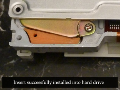

I might have found a solution that does not require removing the voice coil top magnet. I simply use a water hose washer, the flat kind that's usually orange/brown. I cut about a quarter of it, and insert it between the two magnets, in the space directly to the left of the preamp PCB. Somehow the dimensions are just right. This piece of rubber fits snuggly by friction, and it prevents the actuator from touching the gooed crash stop bumper. I "fixed" two drives that way, one single and one double platter, and they both work. See photos below.

I make those and they do work. You can check the item feedback.
It prevents contact with the sticky rubber and won't interfere with the parking mechanism.
You don't need to expose the drive internals more than this:

It would seem to me using a water hose washer would probably be significantly cheaper!
You'll have to take off more if not all of the upper cover, increasing the risk of dust contamination, as well as the top head magnet to fit those, which incurs the risk of disturbing the head too much vertically and breaking the drive. So yeah, it is cheaper, but also riskier. Just depends on what you're willing to spend and risk when trying to fix one of these.
