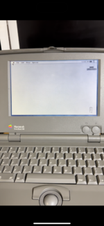

Real quick: if you haven’t seen, I recently eBay’d a PowerBook 100 and got it running again with a healthy dose of new caps. Here’s a pic:
And here’s the thread detailing my repairs: https://68kmla.org/bb/index.php?threads/here-we-go-again-powerbook-100-recap-restore.43014/
Anyways, it seems I really do have a problem as I just bought a PowerBook 150 to fix… it boots at least, which was a requirement as these have a nasty leaky PRAM battery that kills them. Hinges are busted as usual, will have to fix them with some 3D printing as usual. Also has a dead drive, but I’ve got spares (they use IDE!) and while I’m in there I’ll probably recap the screen for good measure. Apparently the battery even holds charge (hah!). I’ll update when it arrives, shouldn’t be too too difficult at this point. I wanted one just because they’re so….weird. Just had to have one for the collection, and finding one that works will only get harder with those batteries.
