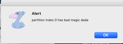

the last couple of days I've been trying to install the A/UX 3.0.1 onto my RaSCSI under SE/30 with a Mac-ROMinator. Unfortunately, to no avail.
Firstly:
I do not have a working floppy drive, so I tried to go around that by using Basilisk and creating disk images. Unfortunately, a disk image simply copy-pasted from the original boot floppy for AUX install gets stuck on the 'Welcome to Macintosh' screen. Now, when I replace the system folder with the one that's on the Mac-ROMinator ROM drive, it boots, but it does not auto-start the actual unix nor the installation process. When I run it manually, it drops a million errors before it even starts loading (it just displays the 'command prompt').
I noticed the original boot floppy (downloaded from MacintoshRepository) has 2 extensions on it - Hardware System Update and CD Hack. So, I copy-pasted those two files onto my fake-floppy boot disk with the system folder from Mac-ROMinator. Unfortunately, it once again gets stuck on the 'Welcome to Macintosh' screen.
In RaSCSI I have selected for the actual A/UX install ISO to mimic the Apple CD rom. This drive always shows up without issues.
Is this stuck screen perhaps because of the 32bit ROM?
Secondly:
Does some kind soul have an ready-to-go image from their RaSCSI (I've seen the one for blueSCSI but that's an IMG file, which RaSCSI doesn't recognise and which IDK how to convert to other ones without messing it up)? Or maybe faced this issue themselves and knows how to work with this?

Yes, any image .hda or .hdr will work. I can just load that as a disk into the raSCSI
I haven’t done it myself, but a ‘dd’ image file from Mac OS X should be able to just have the .hda or .hdr extension added to work. Do you agree?
If this is true, I’ll fire up my G5 with a SCSI card and ‘dd’ the A/UX installation Jaz cartridge I made for A/UX 3.0.1 and upload it for you to try. Let me know your thoughts about the process and if it sounds plausible I’ll put the time in.
I am not sure about adding the .hda extension myself. If you would find time to do that, I’d be so grateful! I’ll make sure to come back to you to let you know how it went. Is that gonna be an image of the disk itself or of the install files? Thanks!
