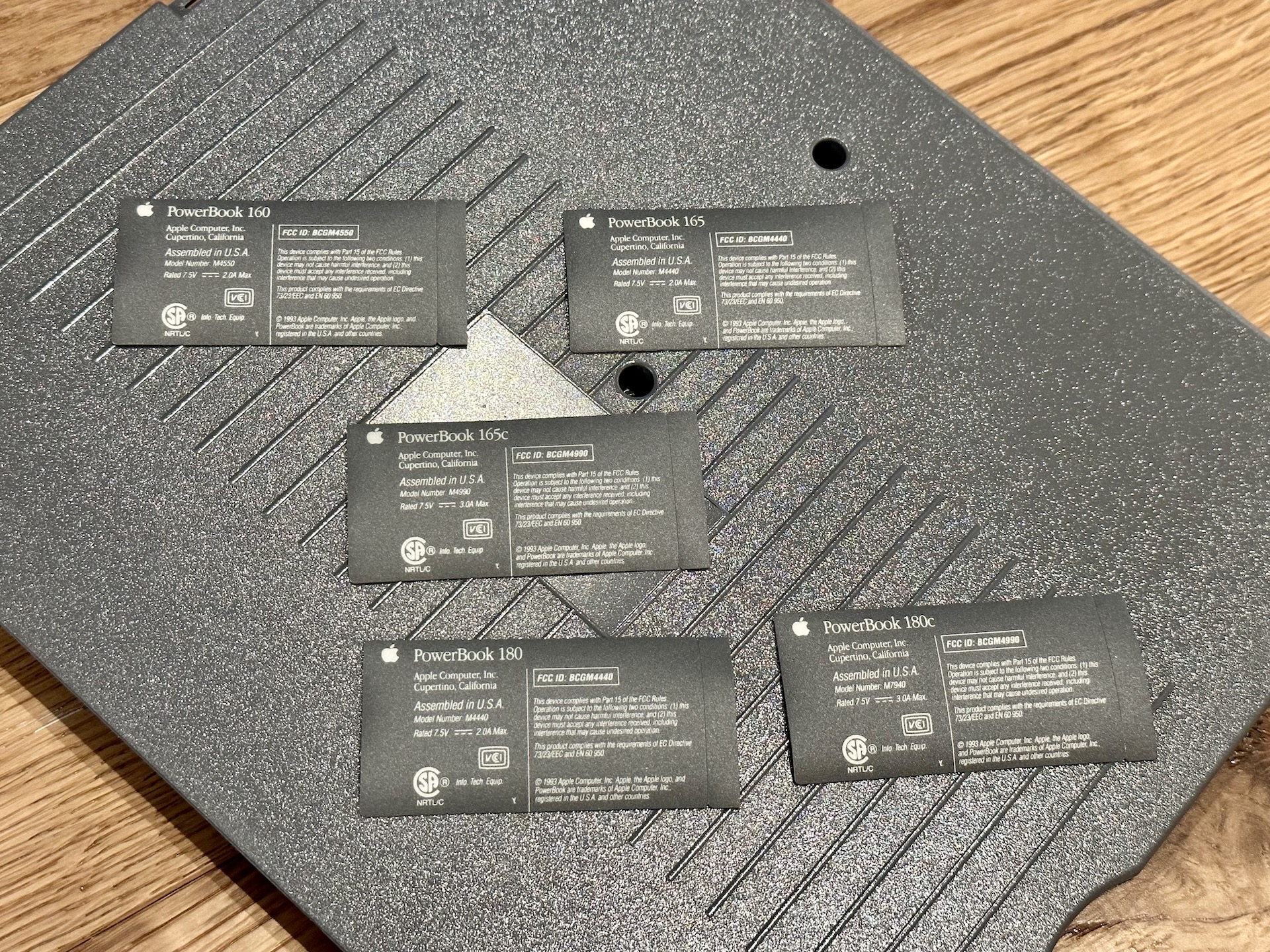

the rear casing for the 150 is the same size as the 140 right?, i may keep this feed in mind as i too have been contemplating rebuilding an entire rear shell (because i was an idiot and threw the old one away dispute the fact it was 100% salvageable, however my problem is my lack of knowing how CAD works, i wouldn't even know how to reproduce a back, i do have the Area measurements of the front bezel if that's any help to anyone?
3lectr1cPPC
The 150's rear casing is different from the 140's in a few ways. Probably minor enough to make it work, but not ideal. The 140, 145, 145B, 160, 165, 170, and 180 are all nearly if not completely identical as far as I know though. The 170 and 180 may be slightly different but I'm not sure.
demik
Actually they are identical. When you bough a spare case from an Apple Store back then, it was sold with a set of stickers for all similar PowerBooks
Only the PB150 is different indeed.
What was different is the c models (ex 165c) where the screen case was bigger due to the color TFT.

I was talking about the rear display housings. The logo is in a different spot on the 150 and inside it’s designed so the LCD cable routes behind the hinge instead of in front of it.
(170 on the left, 150 on the right)
The bottom is slightly different as well though.
Sticker is the other way around and there’s an extra lip for a SN sticker.
