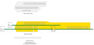

Unfortunately, I've tried several "standard" PCI Riser boards such as you've ordered and none have worked.
I won't use it as is.
As the #INTA through #INTD lines, and what I'd guess are #REQ and #GNT lines are pulled from the other slots through the PCI fingers, I figure it's easy enough to just lob the connectors off, and rewire Slot B's #INTA to #INTD pins to the #PCI_SLOT2_INT signal on A9, Slot B's #REQ to B14, and #GNT to A14. Same deal for Slot C, just to the other reserved pins (#INTA to #INTD to A11, #REQ to B18, #GNT to A19).
For Slot A, all the wiring is basically already good to go. Otherwise, it's just a matter of removing any #IDSEL resistors that are wired up incorrectly, setting a 22 Ohm resistor between #AD14 and #IDSEL on Slot B, and #AD15 and #IDSEL on Slot C, with Slot A's #IDSEL already being handled on the logic board itself. If I'm not mistaken, that should get the riser to work on all three PCI slots.

Indeed, didn't mean that you'd doing so. I was saying that I tried a few that had and a couple that did not have the slot tentacles. When I discovered that Apple had utilized RESERVED lines on the logic board connector to interface with the Riser, it didn't look like a good approach to cut and bodge traces on the Risers in hand.
Doing that on the straight thru cable based risers now. The INT lines appear to be a proprietary misuse of the PCI standard. In the last post before you joined in, trag had this to say:
In any given PCI slot, Apple has traditionally (in this generation, don't know about Intel and late PPC stuff) wired all four INTs together. So there's a single unique INT per PCI slot. Every slot has it's own unique INT. So, when the interrupt manager (e.g. Grand Central on X500/X600) receives an interrupt, it knows exactly which slot it came from. So, my guess is that your PCI header on the 6400/6500 logic board runs a unique INT to each of the four INT pins in the header slot, but then runs just one of those four to each PCI slot on the riser card. So each PCI slot on the riser card gets its own unique INT from the header slot and uses that one INT for all four INT pins in the slot.
They would still need to steal some unused pins in that PCI header to provide Bus Grant and Bus Request lines to each of the riser card slots.
That's why I'm drilling down to the Logic Board connector from all the pins of Slot B ATM. I should have a second 1U Riser in hand by next Saturday. Usint a pair of them does a 180. That places the Logic Board's soldertail nubbins on the same side as those of Slots A&B. That'll make buzzing connections in the search of any further Apple's PCI shenanigans a snap.

Yup, @trag pretty much had it spot on that Apple wires all INT lines per slot to a singular, slot specific INT line, rather than follow the PCI spec and have individual lines that get rotated between slots, alongside the slot specific GNT and REQ lines.
The INT for Slot C was confirmed per the 6500 schematic, as they left the connection to the PCI slot as well as the cache slot (again, curious what the idea behind that is), but removed the GNT and REQ and left those pins as reserved as the lines got repurposed for the ATi chip instead.
I basically theorized it, then followed up with actually buzzing it out on a 6400 board, which confirmed the GNT and REQ connection points. I don't think it should be too hard to solder some thin magnet wire to whatever bits of copper comes off the reserved PCI pins on the riser's PCI edge connector, and run them to the connector solder points for Slot B and C to wire them together.
EDIT: For example, a similar riser has the connectors wired up as such:
So, just a case of running the INT connections to pin 1 through 4, GNT to 6, REQ to 7, and a resistor to the right address line to IDSEL. The CLK could be connected from PCI1 to PCI2 and PCI3 with a single magnet wire across the PCI slot solder joints, soldered to all CLK pins.

I think a novel way to implement it on the 6400, is to implement a PCI device on a new two card riser itself as the third PCI device. The riser could be horizontally elongated, to have some space for the circuitry. Then you could for instance make a riser with SiI3112 SATA on it, or even a PCI-PCI bridge and multiple devices like SiI3112 SATA + USB + FW, and still have two PCI Slots available for further expansion. With a CSII Ethernet NIC, that gives the machine quite a bit of upgradability.
Interesting, might work with SMT connectors on both sides using a lot of layers on the Riser PCB? IIRC, somewhere in my TwinSlot riser threads I have illustrations for implementing a MiniPCI connector on the solder side of the TAM's CSII riser.
Was so jealous of this brilliant idea because your tricked out PCI/Riser wouldn't work in the 6360 or TAM which were the inspirations for the TwinSlot Project.
Well . . . Still no good for the TAM, but the 'ole bend back the harness brace and slide a full length PCI VidCard up under the Optical bay came to mind. Have been figuring on using the stock slot for that long card again. but decided a third card would be better!
I've left Apple's specified 7" card in the stock slot and have extended the 6360 "Riser" underneath the Optical Bay with cubic available for a 5.5" or 6.5" PCI Card in the all but wasted cubic of the speaker well. Bracket on Card in Slot_C is for reference only. Drawer will slide right in with three cards in that config just it did/does with the Full length Thunder Card in my Crescendo G3/L2 powered graphics workstation back in the day.
TwinSlot Riser works in TAM and 5400/5500 AIOs, but no room for my 6360 TriSlot insanity. 🤪
