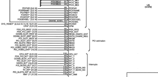

There may be a way to figure this out without shooting too much in the dark. Gazelle reused PSX and O'Hare, and effectively has four PCI slots available out of O'Hare. One goes to the ATi Rage II, one to the COMM slot, and two to the PCI riser slot. The difference is that Alchemy's Valkyrie-AR video IC talks directly to the CPU, thus not using a PCI slot.
So, it can be deduced that Alchemy is only using three of four PCI slots available to it from O'Hare, with the exception of clones that did break it out to three PCI slots and one COMM slot. So, one could reasonably assume that Gazelle's PCI_VIDEO_GRNT and PCI_VIDEO_REQ would have been SLOT3 on Alchemy, if we reference the Gazelle schematics:
The ATI chip receives "VIDEO_INT" instead of "PCI_SLOT3_INT", but as it's not listed as a PCI specific interrupt, I would assume PCI_SLOT3_INT would belong to PCI_SLOT3_GRNT and PCI_SLOT3_REQ on Alchemy.

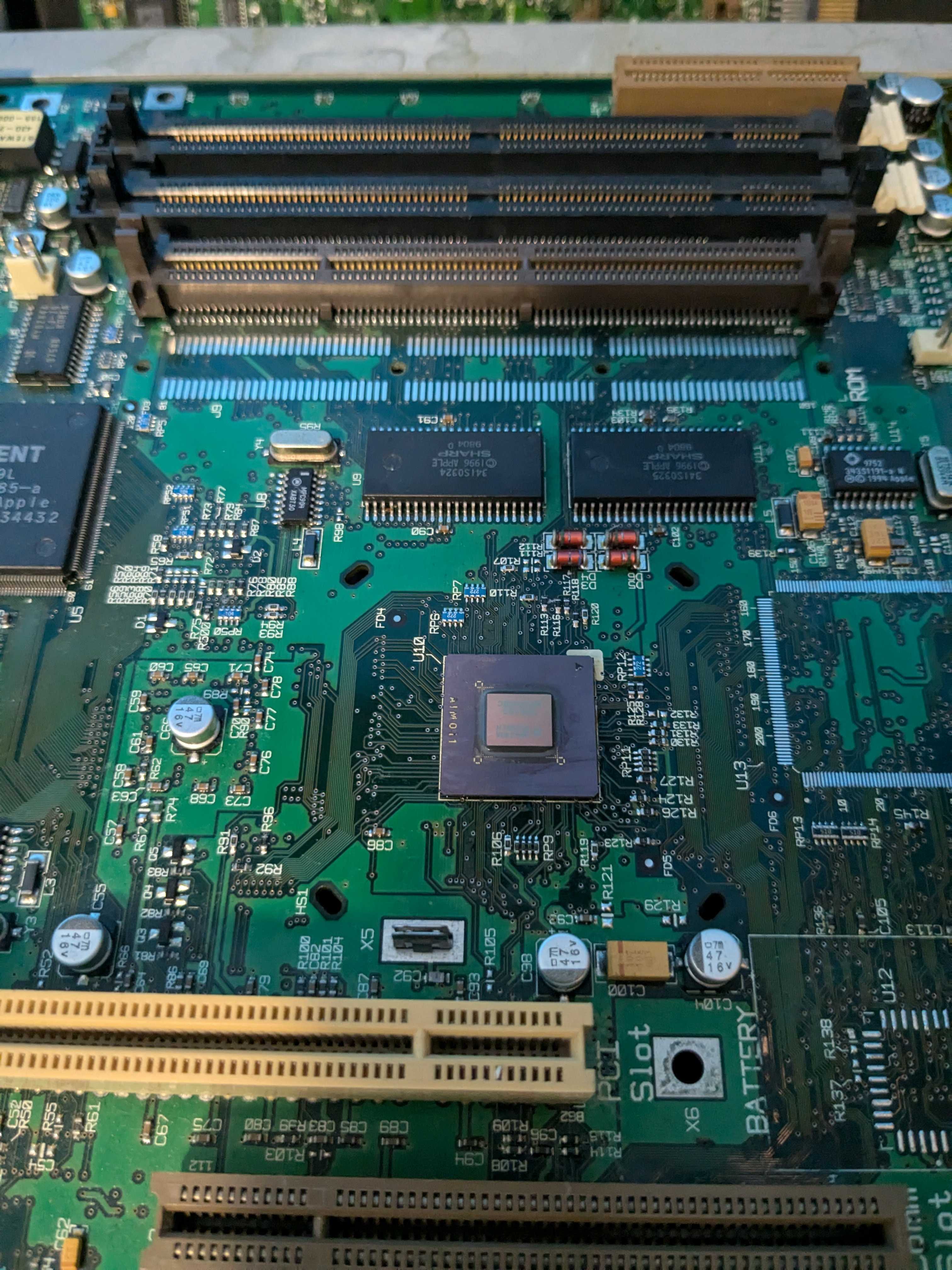

Now that I'm home, and I already have my Performa 6400 logic board out, I got curious myself.

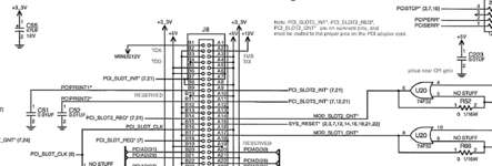

On the Gazelle schematic, there is actually a connection for PCI_SLOT3_INT on A11.
On Alchemy, I can confirm it is a direct connection to pin 117 on O'Hare, as well as pin 136 on the cache connector (PCI_SLOT3_INT travels there too, for some reason).

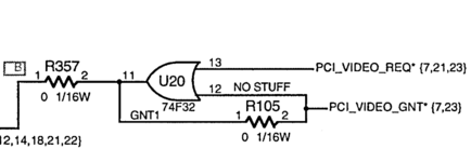

Well, there's a reserved pin on side B, B10, which is near PCI_SLOT_REQ on B18 and and PCI_SLOT_REQ2 on B14.
Steps of four, so I checked continuity from B10 to pin 13 of U23 (74F32 on Alchemy, which is U20 on Gazelle):
Yes, there is a connection from pin 13, the REQ signal on 74F32, to B10!
So that's wired up, leaving just MOD_SLOT3_GNT, which should be on pin 11 of U23.
Well, on side A, near MOD_SLOT2_GNT on A14 and MOD_SLOT1_GNT on A17, there's another reserved pin on A19.
Sure enough, continuity to pin 11 of U23, which should be MOD_SLOT3_GNT on Alchemy!

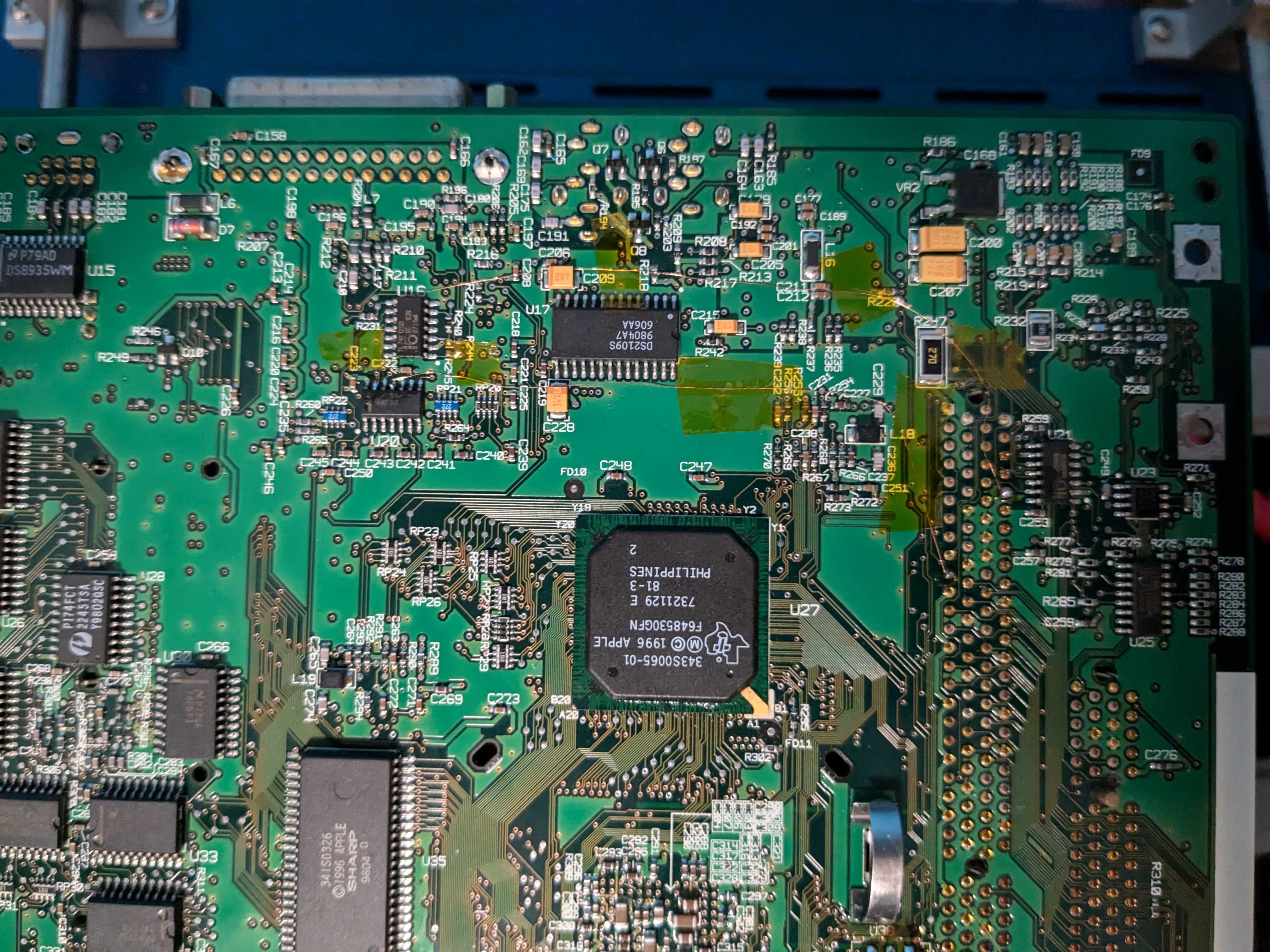

Also, on a 6500 board with damaged ATi VRAM traces, I've decided to just forgo the ATi Rage II entirely, in favor of just obtaining the third PCI slot again, which I did by rerouting the PCI_VIDEO_GNT and PCI_VIDEO_REQ signals on U20 back the according pins the Alchemy boards use for Slot C.
A bonus to pulling the ATi chip, is that the PCI bridge problem also goes away.
Can't have buggy ATi Rage II fCode if there's no ATi Rage II chip :-p
