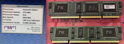

I picked up a 6500/275 motherboard off eBay for reasonable price, I’ve been playing around with upgrades for my 6360 and was interested in finding a 512KB L2 cache. It might be out there somewhere but the identifying part numbers printed on the Apple L2 cache modules have been hard to find. In case others are interested:
IDT7MPV6284 - 512KB
IDT7MPV6283 - 256KB
Fronts:
Backs:
I believe these work in any Alchemy (6360/5400/6400), Gazelle (5500/6500/TAM) or Tanzania (4400/Clones) motherboard.
I’m going to run some benchmarks in my compatible motherboards and post results here.

Just to be clear, the two pictures I posted each show both the Apple L2 Cache modules, with the 512k card above the 256k card. I just flipped the modules over for the second picture.
The 512k module has (4) "IDT 71V433" chips vs. only (2) on the 256k module, I take this to be the actual cache memory (doubled for 512k).
The 512k module has (2) "IDT 71V218" chips vs. only (1) on the 256k module, function? (doubled for 512k).
Both the 512k and 256k modules have (1) "IDT 74FCT" chip, function?
Both the 512k and 256k modules have (8) "IDT 74FST" chips, function?
The Motorola Starmax versions @jessenator posted show the 256k front and back and then the 512k front and back. It looks like the 512k module has double the number of "IDT 71256" chips, with what looks to be the same number of the two other chips (one chip has a sticker blocking, but the "IDT 71216" is the same).
Seems like Apple and Motorola apparently accomplishing the same thing with different parts.

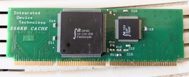

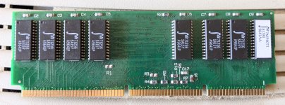

Here's my 256KiB IDT branded IDT7MP6071 cache module that I have installed in my 6360. When I bought it from eBay some time ago, I believe it was listed as for a 7600. It has eight IDT 71256 15ns 5v 32k*8 SRAM ICs, one IDT 71216S12PF 16k*15 tag SRAM IC with integrated comparators that appears to be specifically catered to PowerPC and other RISC platforms and rated up to 66MHz. The large IC is a mystery to me. It looks like the later IDT7MP6071A module (like in Jessenator's photo above) is lower profile and uses a significantly smaller IC.
<missing image>
<missing image>
@rsolberg
21 hours ago, Fizzbinn said:​
The 512k module has (4) "IDT71V433" chips vs. only (2) on the 256k module, I take this to be the actual cache memory (doubled for 512k).​
IDT71V433 is a 32k*32 bit 3.3v SRAM, making them 128KiB each. I believe it's 11ns based on your photos.
The 512k module has (2) "IDT71V218" chips vs. only (1) on the 256k module, function? (doubled for 512k).​
These are 3.3v cache tag SRAM in an 8k*16 bit configuration, making 128k bits/ 16KiB each. Yours appear to be 12ns
Both the 512k and 256k modules have (1) "IDT74FCT" chip, function?​
Both the 512k and 256k modules have (8) "IDT74FST" chips, function?​
The IDT74FCT163373 is a 3.3v 16-bit transparent latch, which I suspect is being used to buffer the tag SRAM, or could be used for part of the level shifting circuitry
The IDT74FST3xxx ICs are level shifting bus switches. As Trag suspected, the SRAM in your modules is 3.3v, but the cache logic on our logic boards is 5v. Basically most of the extra ICs are to manage this difference. The use of 3.3v SRAM may have been a necessity for economics or availability since your modules have 1997 date codes compared to 1996 for mine, or it could be to create compatibility with systems that use 3.3v logic for the cache. With the level shift bus switches, they should be compatible with both 3.3 and 5v logic on the bus.

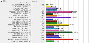

...and the MacBench 4 results are in!
Really no big surprises here, more L2 cache = better and the same L2 cache slot G3 upgrade runs pretty much identically on these platforms (even though the 6500 series uses a faster 50MHz bus - the large 1MB G3 L2 cache likely makes that moot).
One thing you'll notice is there are no results for the Umax SumperMac c500/180 with 512KB L2 cache, I didn't skip that one, I just couldn't get it to boot successfully with my IDT7MPV6284 512KB L2 cache module installed (which worked fine on the other platforms), it would always lock up right before the extensions loaded.
I tried to keep the parameters of the test machines consistent outside the L2 cache slot contents.
  • Same 160GB IDE hard drive running the same install of Mac OS 8.6 (originally done on the Power Macintosh 4400)
  • AppleTalk off, Virtual memory off, Disk Cache 2560KB, Monitor set to 640x480 and 16-bit thousands of colors
  • Same two 64MB 5v EDO DIMMs except the for the 4400 where I only have 80MB total at present of 3.3v kind it uses
  • For consistent MacBench CD-ROM access even moved the same 12x SCSI CD-ROM between all the machines except the 4400 which has a 12x IDE CD-ROM
I'll post the other test graphs in a bit, I wanted to get something up tonight after I finished but I'm running out of steam now.

@Fizzbinn
Additional MacBench test results
Floating Point - Pretty much inline with the Processor test:
Graphics - Somewhat surprising that the older models, lacking ATI chipsets, faired better with the G3 upgrade, of course they can't support higher resolutions/bit depths with only 1MB of video RAM. The test config was pretty low end, 640x480 and 16-bit thousands of colors:
Disk - Looks like the Power Macintosh 4400's IDE bus lags the others. The test config used the same 160GB IDE hard drive on all systems/tests:
CD-ROM - Again the Power Macintosh 4400 lags the others, this time more significantly. The test config used the same 12x SCSI CD-ROM on all systems except the 4400 which has a 12x IDE CD-ROM:
Other Notes:
The Umax SuperMac c500's original 256KB L2 Cache module was the IDT7MPV6071. While I could not get it to boot with my 512KB L2 Cache module IDT7MPV6284, I wonder if it might have worked with the older (IDT7MPV6076) or newer (IDT7MPV6289) version.
Also my Power Macintosh 4400's stock 256KB L2 Cache module was the IDT7MPV6283.
