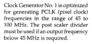

Just to let you know, how to calculate parameters for "setlong" function.
case 29:
setregistermin(0);
setregistermax(3);
setlong(13,7,2);
setregistermin(1);
setregistermax(2);
break;
setlong expect 3 parameters corresponding to Ni, Mi, and Pi in the calculation from the datasheet (attached).
First choose desired Clock-speed (29Mhz)
Than add 0,1 as 29,05Mhz is nicer that 28,95Mhz (29,1Mhz)
Next divide by 2 as MC88920/16 will double the frequency later on(14,55Mhz)
Chose divider P from 1,2,4,8 in that way that 14,55*P is smaller than 100Mhz and bigger than 45Mhz
For 20-25Mhz CPU clock 8 will work, for 25-50Mhz 4 will work, above use 2,
Multiplier 1 is coded as 0 in last parameter
Multiplier 2 is coded as 1 in last parameter
Multiplier 4 is coded as 2 in last parameter
Multiplier 8 is coded as 3 in last parameter
So 14,55Mhz*4=58,2Mhz. Last parameter = 2
Next divide crystal frequency (31,3344Mhz) by the frequency calculated (58,2Mhz)
Results 0.538391753
Ask your spreadsheet calculation to format that as a two-digit fraction:
7/13
Enter last number (counter)(13) as first parameter Ni and first number (denominator)(7) as second parameter Mi.
I am not sure if it is really named counter and denominator.

For Omega, the pixel clock is fully programmable but the CPU clock is set to one of 4 canned settings by resistors being present or not.
Omega does not seem to be as similar to the SC11412 as Gazelle.
Omega might have 28 pins (based on LCIII schematics).
Is there a datasheet for Omega?
