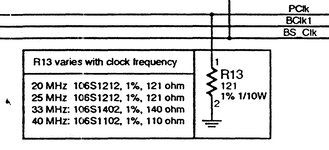

There is also a resistor R13 that it might be worth tweaking the value of - it's on PClk and technically should be tuned for your frequency. While we have values for 20, 25, 33 and 40, sadly they can't be trivially extrapolated because there seems to be an inflection. I haven't experimented with R13 yet.
Time for a peltier cooler and 60MHz! (If you do, make sure you protect the board from the condensation).
Oh, maybe I should swap it out for a 110R resistor.
