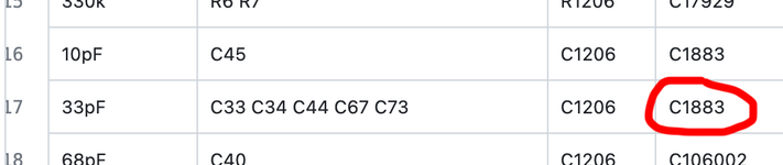

I found another interesting thing, which may or may not be important but I had some of the pick and place capacitors off for testing last night and the parts which should be 33pF are 10pF parts. Is this a reasonable substitution?
I know why my 33pF parts were wrongly picked now.
There is an error on the BOM on GitHub –
The 33pF parts have the wrong LCSC Part # listed. It is C1883, but it should be C1906.
Thanks to @ThisDoesNotCompute , I read your group buy thread over on TinkerDifferent, and I noticed that you flagged this up in your own BOM.
I imagine boards which were ordered with pick and place may have the wrong value caps at the five locations it applies to.
I hope this last post doesn't come across as critical, the Reloaded project was a huge undertaking done for the benefit of the community, and I'm always appreciative. This is just a minor and probably unimportant error but I thought it would be good to flag it up.

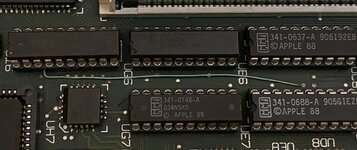

So tonight I’ve been looking at my original SE/30 boards and found that pin 6 of the PAL at UE7 doesn’t go to /Nubus. It has continuity with pin 89 on the PDS connector, which is labelled /LAS.

Ok. I think I see what’s going on. You know the bodge wire that the early revision boards have - well, the Apple photocopied schematics on the internet are from before Apple found and applied this. And if the Reloaded board was based off those schematics, then that would account for the error.
Very nice sleuthing! I just looked at the Reloaded gerber files and you're right. They match the leaked Apple schematics with UE7 pin 6 going to U18 pin 33 and PDS pin 82.
Bomarc's reverse engineered schematics match what you observed on your original boards with UE7 pin 6 going to PDS pin 89 (C9):

Purely as an experiment, and for my own entertainment, I took one of my original SE/30 boards with the factory bodge wire and reversed it so that it would run like a Reloaded board, with UE7 connected to /Nubus. I ran it for an hour and could not see any artifacting. This is not really surprising since only like 1-2% (I guess??) of the Reloaded builds actually exhibit any issues and the same could be true for the original boards too. My conjecture is that it probably took Apple a while to find and fix the problem since it was only very occasionally showing up and by that time the boards had already gone to mass production. So the SE/30 engineers were probably very well aware of the problem and we've kind of gone through Apple's forgotten troubleshooting process again, almost 35 years later.

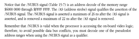

Here's what Designing Cards and Drivers for the Macintosh Family (3rd Edition) says about /NUBUS:
Sounds like it's basically a copy of /AS that is slightly delayed and only activates in the $60000000 to $FFFFFFFF range? Since onboard video is inside that range, they are basically the exact same signals for UE7's purposes except /NUBUS is 20-ish nanoseconds delayed...

...and those 20-ish nanoseconds of delay could be very important, if they're the difference between meeting the setup time requirements for data written to video memory, and not meeting those requirements. Touching /NUBUS with a probe would add extra capacitance like I was babbling about previously, which would cause the edge of /NUBUS to arrive at the RAM slightly later, which would give enough extra setup time for the data to be received and written correctly.
This explanation would make sense if /Nubus arrived early, but it’s arriving late?
Amazing work and I am more amazed at the talent that is in the community along with how others got involved to find this issue. Glad it is an easy fix and looking forward to updated Gerber & BOM. What funny, my 2 previous board orders had the wrong cap but my last order seems C1883 was out of stock and somehow I replaced it correctly with C1906.
I'm a little unclear on exactly how to implement the fix. The photo above of the factory bodge wire shows it going from (a test point apparently connected to) pin 14 of UG7 to under the socket on UI6. Where does it go? And would that bodge be applicable to the Reloaded board?
