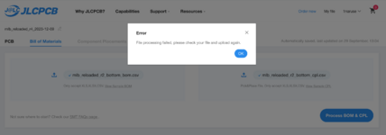

So I am trying to set up an order of PCBs for the logic board of @Bolle's SE/30 logic board in JLCPCB.
I have downloaded the board files from https://github.com/TheRealBolle/SE30/blob/main/Board Files/mlb_reloaded_r4_2023-12-09.zip (notice the r4) and when I get asked to upload the BOM and CPL files (Which I got them from https://github.com/TheRealBolle/SE30/tree/main/BOM and pick & place files) (the files are r2)
I get his error on JLCPCB.
Could this be because the versions are different? (r2 and r4). thoughts?
Also, as a Followup question -- is there any BOM CPL files for the top? -- I can imagine the sockets for the various surface mounted ICs + through hole ones (the ones one can get) and the couple of diodes available
there is no newer bom/pick and place fileset, it's just the board itself that changed. try downloading them again.
there's a topside BOM some youtuber made, but i do not recommend that. you'd have to coordinate jlcpcb ordering non-stocked items and also more importantly the cost to assemble both bottom AND top is significantly pricier.
also you're in canada right. you're gonna get hit hard with duties.
