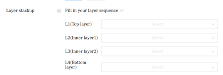

I was looking at adding to a JLCPCB order, and noticed it asked me for the layer order (which layer is the top layer, which on the top-middle layer, which the bottom-middle layer, which the bottom layer). I think I know what files should be picked, but I figured I ask here what should be picked there, so others with the same question can read it here :)
The order of the layers is automatically defined by the gerber files - so it seems that something went wrong during your order process (create a zip file from the "board files" folder and upload that).
But as long as the top- and bottom-layers are on the outside, everything else belongs into the esoteric field of discussion (at least for 4 layer designs).
Also the provided BOM/CPL files are meant for the back-side only.
NB: If you choose their SMT service you can only choose green as PCB color! No fancy purple ;)
I downloaded the entire GitHub as a ZIP, then removed all files and folders inside other than the board files folder. Just to be sure, I downloaded the GitHub again, but this time extracted the board files folder and rezipped that. I still get asked for the layer stackup, so I'm not sure if this is required to be filled in? I've not ordered boards more than two layers before, so this might be more obvious for others.
