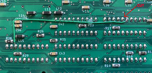

I'm a little unclear on exactly how to implement the fix. The photo above of the factory bodge wire shows it going from (a test point apparently connected to) pin 14 of UG7 to under the socket on UI6. Where does it go? And would that bodge be applicable to the Reloaded board?
This is how I've done one of my boards. You're bodging pin 6 of UE7 to pin 3 of UI6, and cutting the trace that leads to UE7 from the GLUE. It's exactly the same (logically) as the Apple factory bodge, but adjusted physically because the Reloaded board is routed differently.

Did all of them actually have problems? Technically there's no need to modify boards that don't show the problem.
I experimented a bit with one of my boards and could actually reproduce the issue when using TI 150ns VRAM chips. Any of the other VRAM chips I have around seem to fall into the setup time window that still works when using /NUBUS instead of /AS to generate the VRAM /RAS signal.
Do the 150ns chips work fine when using /AS?
They are pulls from original boards, so I'd say yes. Didn't get around to doing the modification on one of my assembled reloaded boards... just swapped around the VRAM chips real quick because I had them socketed on one board.
The /ECS signal fires ahead of /AS, but Apple didn't see a use for it, so it leads to nowhere.
In fairness to Apple, /ECS is pretty useless. It doesn't qualify other signals (/AS mostly does, /DS for data... sometimes) and it can be asserted and then de-asserted without any actual cycle occurring. It's basically just a warning that the CPU might do an useful cycle soon...
