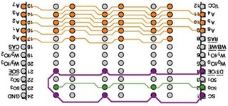

That's from the VRAM pinout, board buzzing looks like this:
Craziness at bottom in purple/green drove me nuts until I realized the VRAM ICs were "upside down" and addressing on lines above became clear thereafter.
I don't understand why S0 on the 4 chips would be tied together. I would double check that.
Those were the first lines I buzzed, they're on a layer labeled WT*? in AI. Haven't looked at them after got over confusion about chips being "upside down" on the card.
That is indeed a much better picture.
Yep, too bad it's "upside down" as well. Figured that out after I couldn't fix that an repost.:rolleyes:

In parallel mode with 16 data and 8 address lines hooked up, I've got only a pair of GPIO lines available. Serial data and "start over" period detection seems like a good approach to load order determination?
If you don't have enough GPIO pins to do one test of 16 data bits, you can do two tests of 8 data bits each.
Actually, instead of reading 1 data bit at a time from a PISO, you might consider reading 8 data bits at a time. I think that has the same level of difficulty as using a PISO? In either case, you have to create a clock. 16 cycles for the PISO or 2 cycles for the 8-bit parallel input. The clock has to be fast enough so that it doesn't last longer than the data is valid. Actually, you could latch the 16 bits, and clock the first 8 bits on the falling edge of /WE and clock the second 8 bits on the rising edge of /WE?

I'm prototyping the process in wire wrap, notating a "real" schematic one wrap at a time. Pi 5 with four times the Cores running at 2.4 times the speed might not even get that job done. Hopefully Pi5 will be able to capture and rotate enough alternateX frames that flicker won't be horrific in this feasiblity study.
