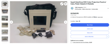

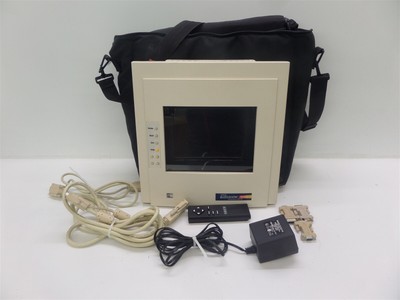

The model for the Portable is the DataShow HR/MP. The DataShow 512C is a 512 color model that probably takes standard VGA.
Finding a DataShow (or one of those PowerBook video out cards) would be interesting to see how a contemporary implementation looks like
