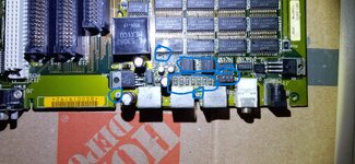

Alright! Thanks! I found JMC's video and he had the list for the floppy drive, And I found that to have an external scsi, you need a diode from 5v to one of the pins, TheTechKnight explains that but I found that out because of JMC. Is that correct?
Welp, all of my stuff for the computer showed up. Thankfully Joes computer museum was kind enough to add a hybrid module after I had ordered. But Its all here, The battery eliminator and the bluescsi with the hybrid module. Just finished soldering them together. Now, just waiting for caps to tear the portable down again!
Does anyone have a detailed video or description on how to install a hybrid module? Thanks!
P.S. My caps are arriving on the 16th! (I hope)
It works, 4 bodge wires (one on the hybrid pins and 3 on the caps), a couple of trace soldering and viola! It fired right up with a new hybrid module and caps with a new usb-c power supply I made and a battery eliminator... It showed that there was no hard drive connected with only like 6 pixels dead! I cant believe it fired up first try.
Thanks to @3lectr1cPPC @finkmac @joevt @SuperSVGA @pl212 and @Juror22 for helping me make this portable alive again.
I will share it starting up when I can. Thanks soooooooooooooo Much!

Let me know what the cap values on the trackball are and I'll add them to my site.
Alright! If you have a portable you'll want to replace them one of them was fine the other had the tell tale electrolytic burning sound.
Caps And Values - 16v 10uF Radial 4mmx8mm
and 50v 1uF Radial 4mmx6mm
There's your values @3lectr1cPPC
