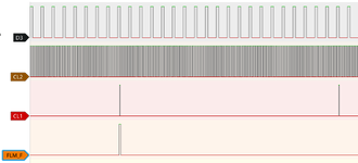

With Omaha2 complete, I moved on to capturing signals from GSC, starting in passive-matrix mode because I can use my singular display panel at the same time I'm running the logic analyzer. I made a few test programs that call SetDepth (to simulate choosing a color depth in the Control Strip) and write to the framebuffer in various repeating patterns. For anyone doing this in the future, make sure you have the system set to 32-bit addressing, or the OS will step in and rewrite the framebuffer with parts of windows while your program is running. The first, most notable thing about GSC is that it formats its output quite differently from passive-matrix mode Omaha2 (this is in 4-grey mode):
Instead of a continuous stream of byte clocks (CL2) with line clocks (CL1) at intervals, bursts of CL2 pulses are evenly spaced and ended with CL1 pulses, with just...nothing between them. FLM_F is also much longer, starting a few cycles into a block of CL2 pulses and lasting until the end of that block, and M_F is always high, instead of alternating.
I noticed that the first bits on D7-D4 of the line synchronous with FLM repeat every 4 lines. There are still 32000 CL2 clocks per frame, and 160 per line, they're just spaced differently. In hindsight, the explanation for this should have been obvious, but I didn't put the pieces together. In fact, I got so stumped that I went and Googled the screens.

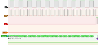

CL2 was fast enough that my pitiful little 24 MHz Saelae clone couldn't keep up, and I was seeing about 170 cycles per line, which definitely doesn't make any sense. I used a Pi Pico 2 with sigrok-pico, which is fine except that its sample buffer is too small to capture a whole frame.
