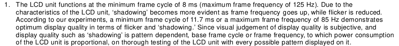

On a related note, Sharp recommends 85 Hz for best results on the passive-matrix LM64P839, and in 16-grey mode, GSC is pushing the screen near its limits:
I do think that 4-grey mode on GSC with a passive-matrix mode looks the best, and that runs at 87 Hz, so maybe they tuned for that. I have no idea about the active-matrix display, but I'm sure that was tuned as well.

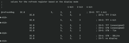

It took me some searching, but Drivers/DeclData/DeclData.r in the System 7.1 source says that MSC is "the LCD display control for DB-Lite machines", presumably Omaha2, and that GSC is "the LCD grayscale controller for DB-Lites and Dartanians". I don't know what DB-Lite refers to (the Wikipedia codename list doesn't mention it), but "Dartanian" is the 180, so DB-Lite probably includes the 160. The DB-Lite folder in DeclData has DBLiteDriver.a, the full driver.
The code doesn't sit down and tell you what each register is, but there appears to be a "refresh" register, a "skew" register, and a "m&n polyadj" register. "Refresh" looks like it's just a mode config, and the chip knows what to do with it:

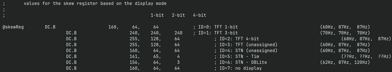

"Skew" sets the frame clocks:

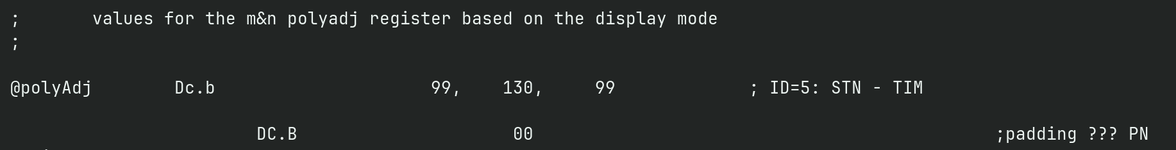

"m&n polyadj" is only defined for the STN display, and since it has m and n in the name, I assume it's some kind of number of lines configuration. I don't know what 99 and 130 mean.1781921001346.png

How do we know this? Is it labeled under the thermal pads that I'm too scared to take off?
"m&n polyadj" is only defined for the STN display, and since it has m and n in the name, I assume it's some kind of number of lines configuration. I don't know what 99 and 130 mean.View attachment 100376

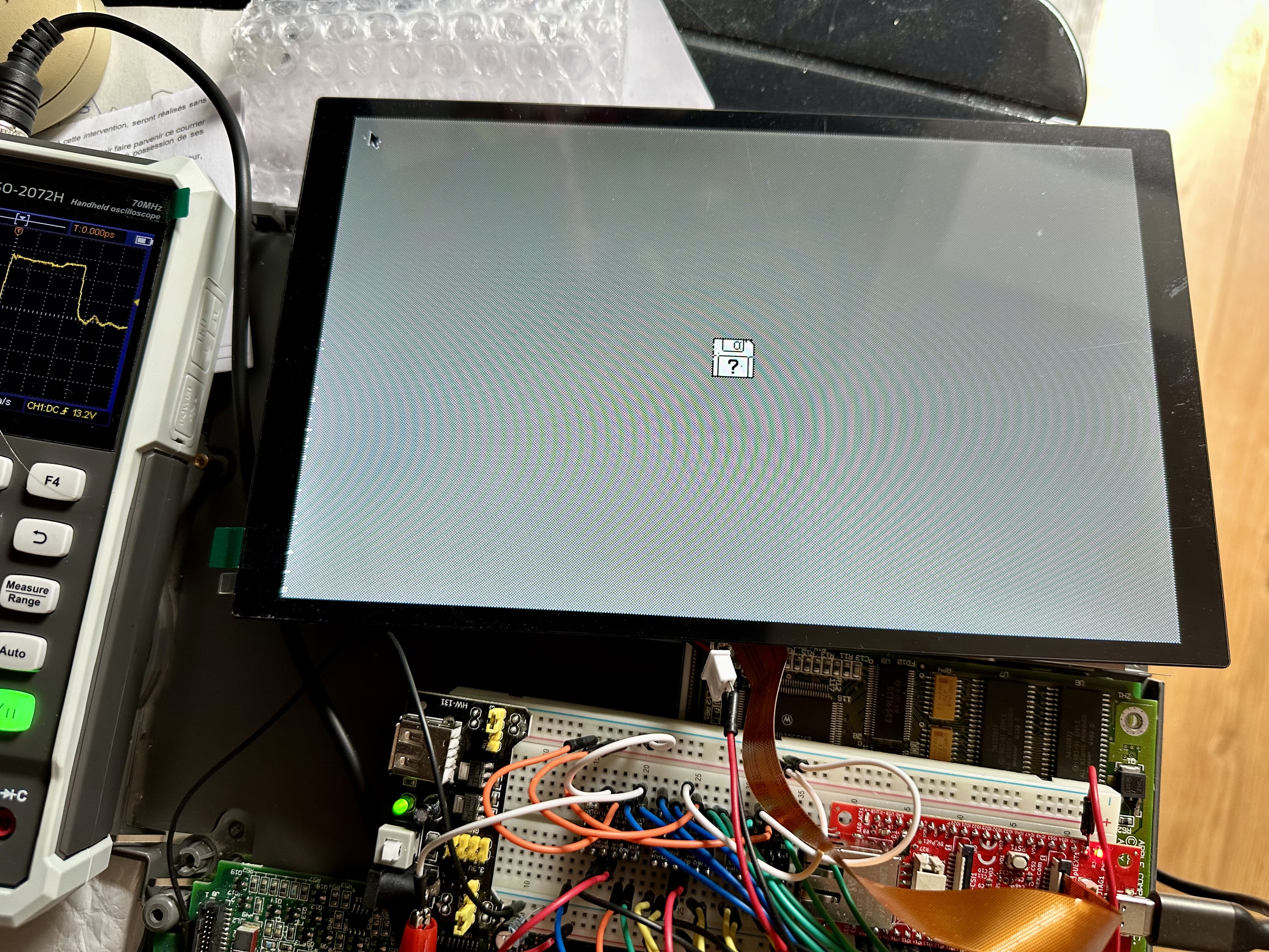

Long-time lurker, first post this thread is what finally pushed me to start reverse-engineering the display on my own PowerBook 180. Huge thanks to liamur first off, your GSC writeups gave me an enormous head start.
Figured I'd throw in some active-matrix numbers from a 180, since most of what's posted so far is off a 145B/160 and a few things come out noticeably different on mine.
Quick setup note in case it's useful to anyone else: I'm probing the 26-pin interconnect directly with an Gusman V6 RP2350 logic analyzer plus a 100MHz 12-bit scope. The LA can hold a full frame at 12.5 MHz sampling, which got me past the buffer-size wall that both the 24 MHz Saleae clone and the Pi Pico 2 hit earlier in this thread.

Timing on the 180, GSC, active-matrix, boot screen showing:
CL2 (byte clock) comes out to about 15.7 MHz inside a burst (63.8ns period), but only 13.06 MHz if you average over a whole line including the gap between bursts. Flagging this because it trips people up my scope reads ~13 MHz since it averages across the gaps, but the LA shows the real 15.7 MHz burst rate. If your number doesn't match someone else's in this thread, this is probably why.
CL1 (line clock) is 40.8 kHz, FLM (frame) is 102 Hz.
Both faster than what's posted for the 145B/160 (CL2 ~9MHz, CL1 28kHz, FLM 87Hz) which tracks, the 180's the fastest of the family at 33 MHz. What I didn't expect is that CL2 and CL1 scale up more than FLM does seems like the 180 has proportionally more dead time between CL2 bursts, so the faster pixel clock isn't translating 1:1 into a higher frame rate.
Frame structure: 320 bytes per line, exactly (320 CL2 pulses between CL1 pulses). Frame period divides cleanly into 400 line-slots too, so 400 active lines and no extra vertical blanking lines tucked in there FLM just marks the frame directly. All consistent with 4 bits/pixel, linear, no dual-scan, matches what you found on active-matrix already.
Also, the boot screen turns out to be a decent free test pattern. The grey desktop background is a 1-bit checkerboard, and on the bus it shows up as alternating lines of 0xF1 and 0x1F (320 identical bytes per line). Two things fall out of that: it's 4bpp with two pixels per byte (you get 0xF/0x1 per nibble, not 0xFF/0x00 per byte), and dark pixels come across as 0x1 rather than 0x0, so GSC isn't using the panel's full range here either same thing you noted for the other modes. Still want to run some proper stripe patterns like yours to actually pin down the pixel format instead of just inferring it from a checkerboard.
On the control lines: DISP_BLANK/ (pin 25) sits low at power-on and goes high a second or two later once the display's initialized, then just stays high decent "data valid" marker if anyone needs one. M_F (pin 19) is held static high the whole time I captured in active-matrix mode, so re: your open question about whether GSC drives M in active-matrix, on my timescale it doesn't, it just parks it high. Caveat though, my captures only cover about 1.5 frames, so I can't rule out a slow polarity toggle at frame rate or slower yet. Longer capture is next on my list.
STN_MODE (pin 23) is static low with no activity. One thing worth mentioning if anyone's probing this themselves: if you see ~13 MHz on that line, that's just CL2 crosstalk bleeding in, not a real signal it's a few tens of mV, well below logic threshold, and the LA correctly reads it flat low. I grounded it externally and booted the machine and nothing changed, so on the 180 it really does look like a static type-select tied to the panel's ground plane, no serial handshake happening on that pin.
On the panel-ID question I've matched all 26 pins on the interconnect against liamur's pinout and there's nothing left over, no mystery lines on the 180. STN_MODE is a static type-select and grounding it boots fine, so no serial ID handshake there. What I can't rule out yet is whether GSC is reading a panel ID off static levels strapped across pins that already have names in the 14x/170 schematic (a few of them differ on the 180). Arbee, since you've dug into the GSCPanelID register and the Duo LCDID pins does GSC on the 180 actually gate video on an ID, or is STN_MODE the only type info it needs? That's the one thing I'd want nailed down before trying to drive GSC with no panel attached.
Happy to share the raw LA captures (VCD/CSV) if anyone wants to poke at them. Thanks again, this is exactly the kind of documentation that makes a project like this feel approachable instead of hopeless.
