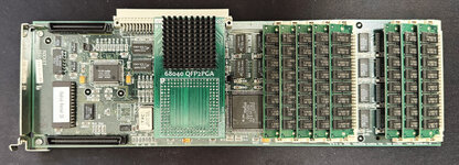

@cheesestraws pointed me at a writeup that @Phipli did on upgrading his Radius Rocket 25i to a Rocket 33:
Decided to give it a try.

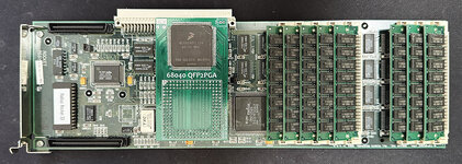

I didn't have any spare socketable full 68040s at 33MHz or higher lying around so I decided to use a QFP to PGA adapter designed by @zigzagjoe that I received from @croissantking in exchange for something recently. The adapter was already populated with a Freescale L88M mask 33MHz 68040 (QFP) that @croissantking had saved from death (it had lost some pins but he was able to save it by shaving some of the packaging in the corners - I think he mentioned it on one of his profile posts a few months back). I picked up a 66.666MHz crystal and burned a 27C256 EPROM with the ROM image for a Rocket 33 which @Bolle had provided in another thread (link here).
Here's the Rocket with new ROM, the adapter which amazingly fits (I think it will probably clear the add on cards too), and the new crystal (I added a socket so I can easily reverse the change). You can see the two corners that were modified by @croissantking to save the chip. And here with a heatsink added:
With the heat sink it will actually prevent the next Nubus socket from being usable. The Freescale chips run a bit cooler but I might add a fan as @zigzagjoe 's adapter conveniently has pads for providing 5V to a fan. I have a 40mm Noctua lying around which I can add once I design a clip that will secure it to the adapter board (I had a clip designed previously for socketed cpus, but since this one is not socketed, won't work).
The modification seems to work. The card does identify itself as a Rocket 33 and I was able to run System 7.1 on it via RocketShare. Seemed stable as I was messing with it. I did not benchmark to prove it's faster. But I assume with the new clock crystal and ROM, it's running at 33MHz.
I haven't decided whether to keep the adapter on there permanently or pick up a new 68040 chip. I kinda don't want to lose a Nubus slot. But then again, I have nothing else I want to put into my IIfx so maybe I'll just leave it for now.
Thanks to @cheesestraws, @Phipli, @zigzagjoe, @croissantking, and @Bolle for the pointers (and ROM image).

Very nice to see that chip being so proudly resurrected. And that is rather serendipitous regarding fitment!
BTW, I see that the decoupling cap at C7 is missing - I would suggest replacing that. I fitted 100nf passives on the backside so you’ll need something like a 100uf cap on the top.
That was at my direction, C7 is for decoupling when the jumper above is cut for current measurements/3.3v operation/other shenanigans. As long as the bottom caps are populated it's not essential as there should also be plenty of capacitance near the 040 socket on the logic board.
✌️ (y)

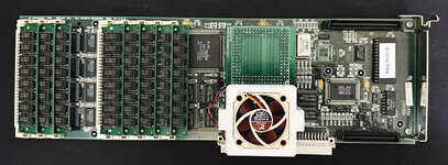

Complete overkill based on what @zigzagjoe said, but decided to just finish what I started since it was already printed.
With fan and retaining clip installed. Note that the angle of the picture makes it look like the clip extends beyond the nubus connector but that is not the case. No clearance problem.
Will leave this for now until I want the slot back at which point I will go with the low profile heat spreader as suggested or go with a socketed CPU.
