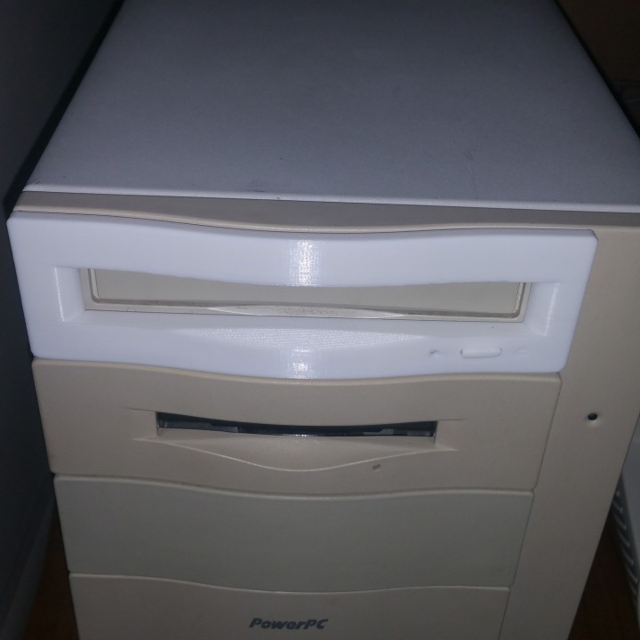

Wait, so it has a tray loading CD-ROM with the wrong type of bezel?
Cause that is definitely the caddy loader bezel.
The tray loader bezel has a larger opening, and has an eject button.

I didn't realise until working with mine that the 840av was sold with both tray and caddy loaders, so it would be potentially possible to make one out of two and have the bezels wrong.
I'm 99% sure the tray loader will not pass through the opening of the caddy loader bezel...

Yup, it does have a tray loader and indeed, someone has placed the wrong bezel on it. And yup, the caddy bezel will not work with the tray loading CD-ROM drive.
I wonder how they got mixed up. Are you going to change the bezel, the drive, or just leave as is?
I will need to check with the guy I got it from to see if he has another that it got accidentally swapped with. But barring that, I have the proper bezel on my Power Macintosh 8500 which I can copy and see if I can make a model of and then 3D print a new one.
There is a model available for a trayloader bezel that's pretty good, might save you some work :-)
There is a model available for a trayloader bezel that's pretty good, might save you some work :)
