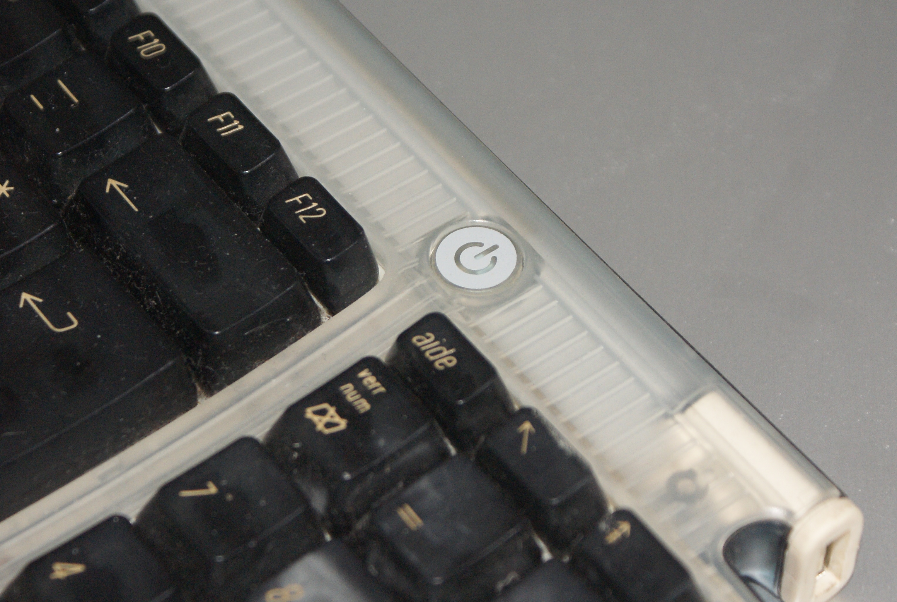

Just a wild guess... the original iMac [USB] keyboard had a power button - I've used one of these on a B&W G3 and it works. I wonder if Apple was considering accommodating this? Could there have been a prototype "beige" keyboard? Or were they using the G3MT/DT as a development platforms for future USB use?
Probably. I’ve bought a USB keyboard with a power button with the vague intention of testing this out. But, I’m not that bothered about soft power really. Even if it worked, the keyboard would be non-functional until the USB extensions load up; so an ADB keyboard is always going to be a better pairing.

I know that USB didn't work before the extension in older machines, I was just wondering if given they have a USB port, late Beige G3s accommodated it.
Note the 9700 prototype with the USB personality card supposedly supports soft power is why I guess that circuit is soft power.

Unless… and this is just crazy thinking, but hear me out, that ‘soft power’ circuit we’re looking at actually somehow facilitates mouse and keyboard input before extensions load.

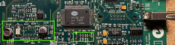

I've populated some more of the card tonight - the passives highlighted in green. It hasn't made any difference. The only other crucial part now, I think, is the oscillator.
One thing I've realised is that my other PCI USB cards no longer work - they are not even seen as USB cards anymore, just as unknown PCI devices. It might be a case of either/or if I get the Perch USB working.
