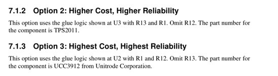

See the attached photos from the CMD 0670 manual.
They give three options for power connection. U9 might well be intended for the UCC 3912 it shows as option 3.
It states to only use one option. So my thinking is that if I have the fuse onboard, I won’t need the chip.
On my Whisper schematic, it looks like the 5v needed to supply bus power would come from VDD on the other side of the fuse. U9 is kinda separate from that circuit. If I were to integrate U9, I would omit the fuse and bus power would come from the chip itself along the same pathway.
The Wings card doesn’t seem to have this chip as part of the footprint at all, although it does have the fuse and big capacitors, again backing up the idea that it’s optional.

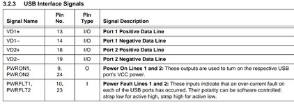

Gi en the error, I'd start by checking that pins 9, 10, 11, 22, 23 and 24 are set up correctly.
Some of those pins are to do with verifying the correct voltages, if you don't have them wired in correctly, the chip will decide the supply isn't working and report a bad port.
It's 3 pins per port.

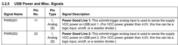

What is pin 11 connected to? Your schematic shows it unconnected, but I think it should be connected to something.

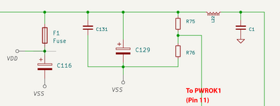

It does. I just updated my schematic. I put 10k resistors on those, no idea if they're right.
Those won't be 10k and this would cause the issue you're seeing. That is a potential divider.
Ideal would be to get values from another mac of similar age (sorry, but there is a gap in my collection, I don't have anything from the early G3 era after beige).
If not... make R76 about 4 times bigger than R76 R75... guessing.
