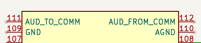

I've been examining the Beige's Modem slot as I'm designing a peripheral for it.
I put this image together which shows exactly which lines have been removed as compared to a standard Comm Slot II. It really does just have the bare minimum of signal lines required for a modem, but usefully all the power lines are there.
You could in theory bodge the 50 or so PCI signal lines from the Perch edge connector – or indeed the USB chip footprint – to the corresponding pins on the modem slot and get a fully functional CSII slot.
Do we know why they decided to leave all these lines out?
At least on Version 2 of the Personality card, those lines are used by the USB chip. I suppose on Version 1 those lines are unused – were they keeping them in reserve for a future USB chip (or another I/O peripheral)?
I'd guess you're probably right with the USB route -- they were probably mid-way through implementing USB when V1 was released, and had been able to free up lines for it without impacting modem functionality, but hadn't actually integrated USB yet. Logic there would be: they could release V1 in its stripped down but known-functional form, and then have flexibility in adding future features.
