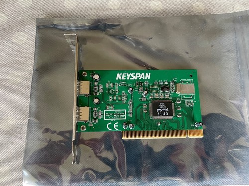

Just under the Firelink chip in your photo there are a whole bunch of them.
Fast blow I'd say.Do I want a slow blow or fast blow fuse at F1?
Any better: ?Just under the Firelink chip in your photo there are a whole bunch of them.
Yes; cheers!Any better: ?

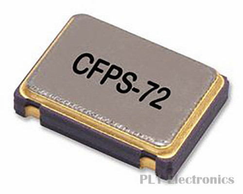

What are the dimensions? Would a 0705 part fit? (7mm x 5mm)I'm trying to work out what oscillator to use, I know for certain it's a 48Mhz part and probably 5V at that
Just looked at this. Yes, it's 7x5mm.What are the dimensions? Would a 0705 part fit? (7mm x 5mm)
Thanks, that's really helpful.I think that is what you are looking for.
Sorry for the delay, here is my best shot I think. Very hard to do without a real macro lens.@mg.man @zefrenchtoon What are the resistor values used, I can't quite see?
