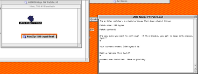

I've included some OpenFirmware dumps and System Profiler screenshots both pre and post bridge FW patch.
Unzipping "6500 Bridge FW Patch.zip" on modern macOS puts the resource fork in a separate file. The zip doesn't appear to include FinderInfo (it assumes all the FinderInfo exists in the resource fork)?
I didn't create the file, this is how I downloaded it, not sure why it's a .zip, I didn't expand it on a non-old-Mac system. I included it for reference and/or if anyone wanted to compare the checksum against whatever was posted somewhere else. Stuffit doesn't like it, but MacZip 1.06 opens it in both Mac OS 8.6 and 9.1 on my 6500.
