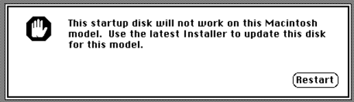

@mihai , well done on getting Mac OS X 10.0 to 10.4 running on emulation. Particularly interesting to see the iMac G3/233 being supported. The reorganisation of the machines makes sense. I keep wondering, Mac OS 8.1 to 9.x don't seem to work on the 6100 emulator: it keeps saying things like:
(Mac OS 8.1) or:
(Mac OS 8.6).
So, is the major problem that they don't have the appropriate System Enablers in the System Folders?
-cheers from Julz
I built those images a while back (for Basilisk II for 8.1 and SheepShaver for everything later). IIRC I did a universal install for all of them, any ideas for what enablers might be required (also, I thought they went away with later OS versions)?

8.6 HD hangs on the 6100 (doing printer port AppleTalk stuff) but the CD should boot.
DingusPPC needs to be modified to properly emulator a printer port or ethernet port that doesn't have anything connected to it.
Mac OS 8.5 appears to hang too.

Yup, same issue has 8.6 with the AppleTalk/printer port. 8.1 AppleTalk/printer port handling is different and doesn't hang.
