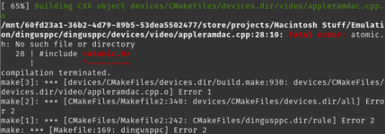

As I said before, you'll need to add this line to appleramdac.cpp if you want it to compile:
#include <atomic.h>
Thank you. I did that and it just throws an error on that instead.
Sorry, I'm not an experienced programmer, especially C++.
Has the atomic.h dependency been added, and it... doesn't exist on my computer? Or is the path bad?
Code:
<userprompt>: /mnt/60fd23a1-36b2-4d79-89b5-53dea5502477/store/projects/Macintosh Stuff/Emulation/dingusppc/dingusppc/build$ make dingusppc

[ 11%] Building CXX object devices/CMakeFiles/devices.dir/video/appleramdac.cpp.o
In file included from /mnt/60fd23a1-36b2-4d79-89b5-53dea5502477/store/projects/Macintosh Stuff/Emulation/dingusppc/dingusppc/devices/ioctrl/macio.h:55,
                 from /mnt/60fd23a1-36b2-4d79-89b5-53dea5502477/store/projects/Macintosh Stuff/Emulation/dingusppc/dingusppc/devices/video/appleramdac.h:28,
                 from /mnt/60fd23a1-36b2-4d79-89b5-53dea5502477/store/projects/Macintosh Stuff/Emulation/dingusppc/dingusppc/devices/video/appleramdac.cpp:25:
/mnt/60fd23a1-36b2-4d79-89b5-53dea5502477/store/projects/Macintosh Stuff/Emulation/dingusppc/dingusppc/devices/common/dbdma.h:153:27: error: field ‘ch_stat’ has incomplete type ‘std::atomic<short unsigned int>’

In file included from /usr/include/c++/11/bits/shared_ptr_atomic.h:33,
                 from /usr/include/c++/11/memory:78,
                 from /mnt/60fd23a1-36b2-4d79-89b5-53dea5502477/store/projects/Macintosh Stuff/Emulation/dingusppc/dingusppc/devices/common/ata/idechannel.h:32,
                 from /mnt/60fd23a1-36b2-4d79-89b5-53dea5502477/store/projects/Macintosh Stuff/Emulation/dingusppc/dingusppc/devices/ioctrl/macio.h:54,
/usr/include/c++/11/bits/atomic_base.h:162:12: note: declaration of ‘struct std::atomic<unsigned char>’
  162 |     struct atomic;
make[3]: *** [devices/CMakeFiles/devices.dir/build.make:930: devices/CMakeFiles/devices.dir/video/appleramdac.cpp.o] Error 1
make[2]: *** [CMakeFiles/Makefile2:340: devices/CMakeFiles/devices.dir/all] Error 2
make[1]: *** [CMakeFiles/Makefile2:242: CMakeFiles/dingusppc.dir/rule] Error 2
make: *** [Makefile:169: dingusppc] Error 2
