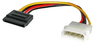

I've been looking up Molex to SATA power connectors and so far it seems like they're literally a sure-fire method for a toasty B&W G3 .
Great. So, how am I supposed to power an internal SATA drive on my B&W G3 given that the PCI card only has data connectors? They do say more expensive ones are better. Would these be OK?
They're more expensive certainly and presuming they're from Farnell, not junk. Though if I'm buying one I should also buy another data cable so I can return my other one back to my iMac G5 (which indeed had a suitable connector).
What would you use?
-cheers from Julz
He has another video on how to select ones that are less likely to fail:
Isn't "here's how bad adapters are made" and "here's how to select good Molex to SATA adapters" the same thing?
Anyway, I watched the video and it looks pretty good. I've been scanning adapters at CPC Farnell.
So, this is a bad one. This one is a crimped Molex to 2x SATA power, which is a 'good' one.

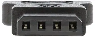

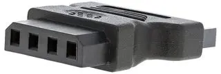

Then there's this one which is curious:
Here it's a Molex female to SATA power pins. Now, there's no cables going into the connector so the cable insulation won't melt; the separation between pins looks pretty robust; the connection pins themselves look sturdy. OTOH, it's just a single molded unit. Finding it hard to figure out how it'll melt plastic and short.
What do people think?
View attachment 91916View attachment 91917
Oh wow, I didn’t know this was a thing - I’ve used these kind of adapters before and currently have one in my Beige G3 DT. Either the risk is overstated or Ive just been lucky.
