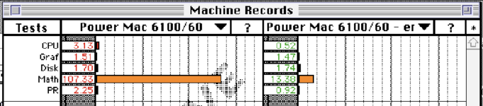

So, I think the tests are misleading here, because they're probably still driven by a lot of 68K code.
Here are Norton System Info benchmarks for Quickdraw video on the 700 and Nubus PPC, all at 256 colours.
I think your conclusion, assuming the architecture is constant and the bus ratio remains the same, that the 88100 based PowerMacs would have slow graphics is probably true if they were the same. The Q700 was fast though. The video speed on the 601s just didn't scale proportionally to the CPU improvement between Q700 and 6100.
Amazing, you've just run it on your real 9500/233? Nevertheless I'm a bit puzzled (maybe due to the glass of wine I've just had) - how can the 9500/233 have slower graphics than a PM8100 - still less than a PM6100? Really curious. the 9500/233 has PCI graphics, or internal video, but the 6100 is using DRAM as video. My head is melting ;-) !
Cool, thanks for that! I think that's what makes the NuMacs really intriguing: for normal applications they'd be pretty poor, primarily because there wouldn't be a sufficient performance advantage in a mixed emulation/native environment in the 1989 to 1992 timeframe. Before doing this guestimation, I kept thinking that the NuMac41 would feel quite nippy despite the emulation hit, because the graphics would be so much faster. This analysis implies that the emulation mode switching would hit UI graphics quite badly, but we'll see in the end it doesn't!
So, if I recalculate this (all hypothetical of course, massive error bars): The MC68040/25 had a SpecInt92 of 13.5 and the graphics performance of a Q700 is 0.75. The PPC 601/60 had a SpecInt92 of 61.6, so its graphics performance should have been: 0.75 x 61.6/13.5 x 0.87 (80:20 rule) = 2.98, but in fact it was 1.51, just over 50% of what it should have been. So some of this is because of the VRAM and RAM bandwidth (but the PPC 601 had a 64-bit data bus, which would have helped), but much of it is the emulation speed and mode switching. Fortunately Speedometer can provide performance ratings for both emulation and native execution:
So, emulation is 6 x slower than native execution (pretty good actually). But graphics under emulation is still 97% of the performance (which is 50% of the ideal performance). This means, I think that although emulation is a significant hit, emulation + mode switching for the graphics isn't a big hit on top of that, instead as you've concluded, it's a bus issue. And yes, if you just take the Q700 graphics performance 0.75 and double it (because we have a 64-bit bus), we get 1.5 which would account for all of that.
So, backtracking, the NuMac 41 runs at 25MHz, with a 32-bit bus, so it wouldn't suffer a bus speed issue vs an LC III, which also runs at 25MHz with a 32-bit bus. An emulation hit of 6x results in a 3% loss of performance for graphics, but the NuMac 41 has something like a 10x hit vs Native speeds, so maybe a 5% loss, making it 0.84 x 0.95 = 0.80, still slightly faster graphics than a Q700.
So, surprisingly, NuMac 41 graphics in most cases would be quick. It'd boot a bit quicker than a Mac SE from SCSI (much slower than an LCIII); windows and menus would react sluggishly on System 7.1, but draw very quickly. E.g. you'd pull a menu down, there would be a lag, but the menu would appear in a single frame. You'd drag a window (outline) around; see fairly big steps between each redraw, but each redraw would be instantaneous. You might find that if you typed quickly in a word-processor it might struggle to keep up with the typing, but the characters and text would snap onto the screen etc.
They're photos from a little while back.
The 9500 is using an absolutely dog slow Radius PCI video card (they don't have any internal video at all). I was testing /how/ slow it was 😆
