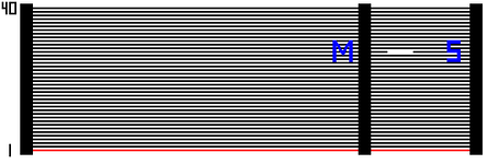

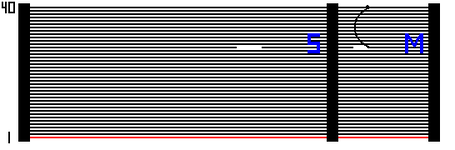

I thought the CS setting just meant it could detect if it was attached to the slave signal or master? So, it wouldn't make any difference, it's just about having less hassle connecting up drives. Perhaps I'm wrong, since thinking about it, there's no twist in the wires for an IDE drive. But that's certainly another option. Oh, it doesn't work by twisting..
Pin 28 is grounded for Master, but floating for slave in CS mode. So, a CS compatible cable connects pin 28 at the master end to a ground signal, but there's no connection for slave. It's equivalent to:
