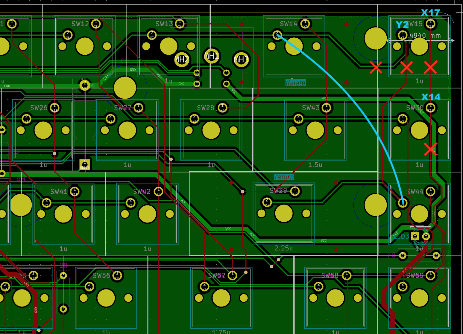

Actually, after looking at the board, I just realized the traces for the X pin for those appears to be on the top of the board, and unless I'm mistaken, I won't be able to access the top of the board without removing every switch. So, looks like I might need to order another batch of PCBs and switches to make this happen... :(
Damn, sorry forgot about that damn plate :oops:
It seems there is still a way. We got lucky with the traces, so remove only PGUP+PGDN switches and cut the top traces from there, then add one wire to fix Y7 (return / backspace). Here is a schematic for you
As for DEL, it's X14 and Y6
- X14 is T, B, G, and left arrow
- Y6 was already used by PGDN so no patching needed there
Just need two spare switches if they don't come easily
Ah, I didn't think about being able to cut the trace after removing the switch... Brilliant! And I already re-assembled my keyboard... Back to the workbench...
