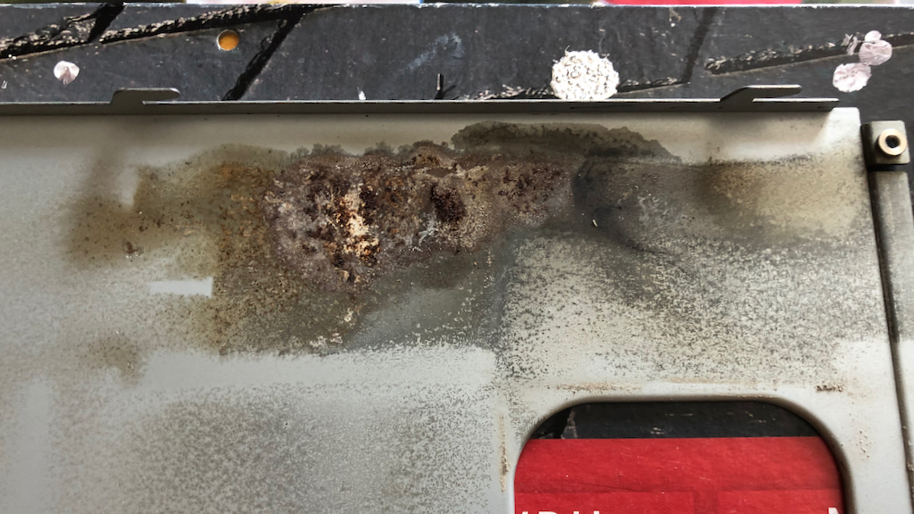

If it makes this sound : View attachment sound.m4a, It's about to blow up, mine died a few minutes after this (with a spectacular bang, as expected)

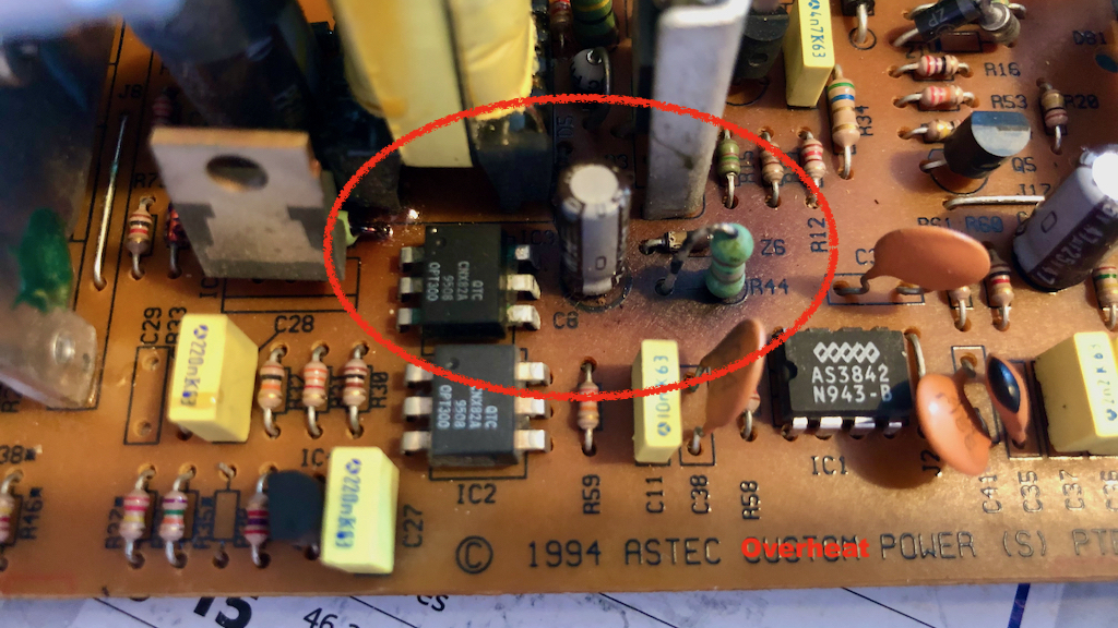

The caps evaporated/overheated into the case, which can result in stuff like this :
There is also overheating marks around some parts :

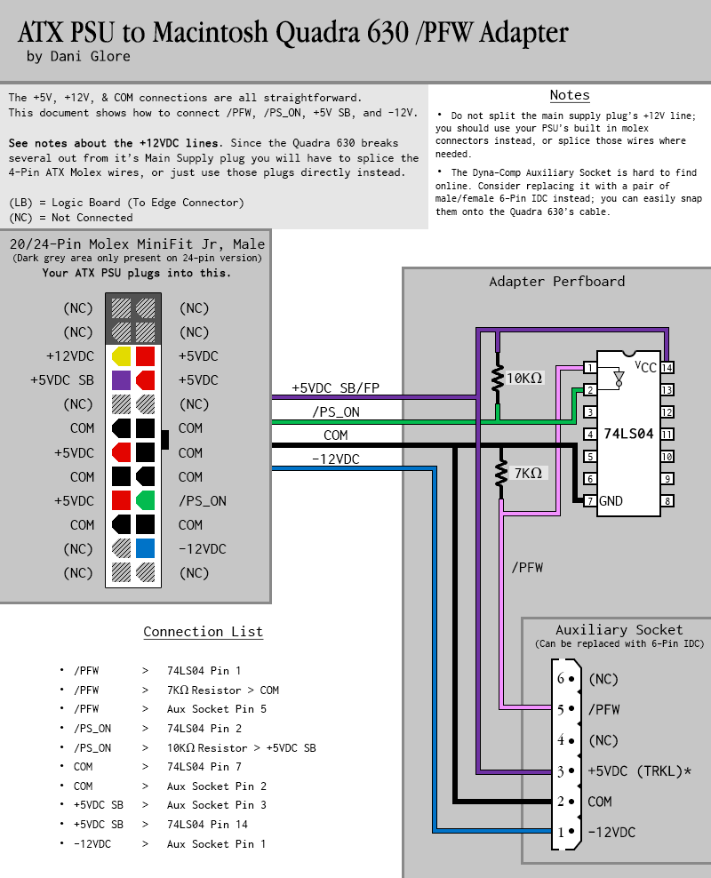

Note : the diagram pictures comes from the following thread, thanks to @Floofies for his work.

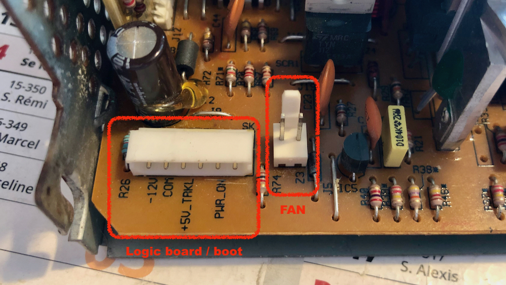

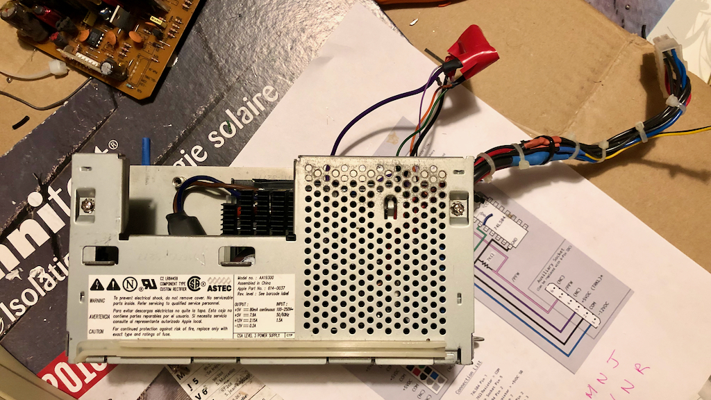

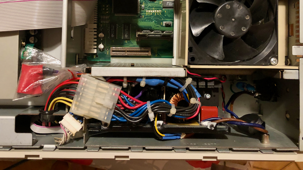

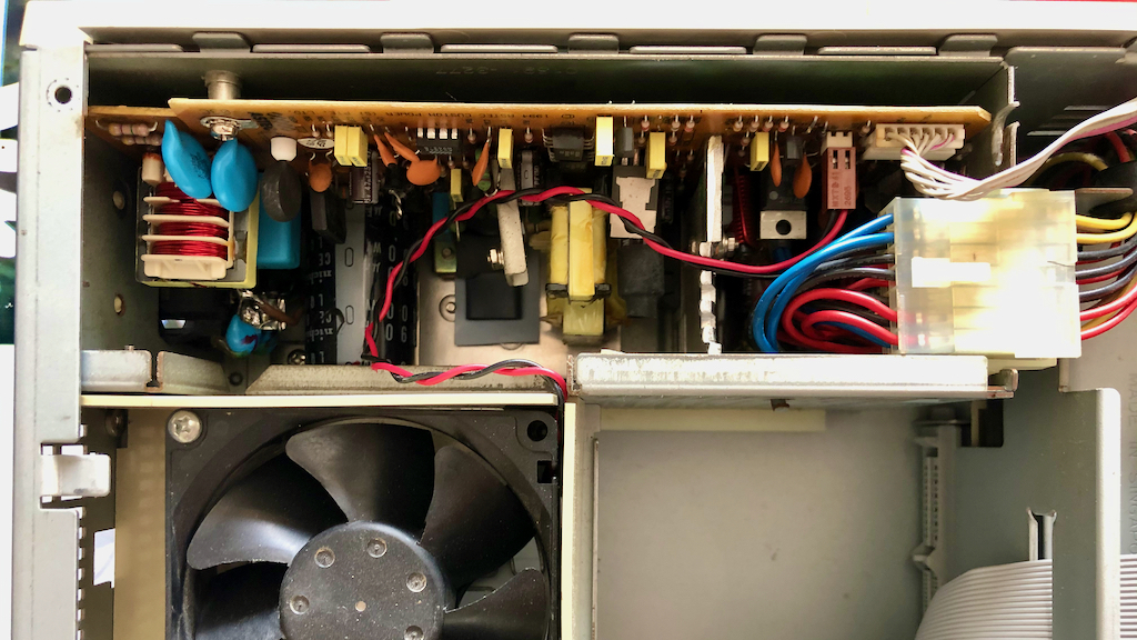

First you need to open the patient, remove the Logic Board and unplug the following wires from the PSU :
- Fan power (two wires, red and black)
- 6 Pins small grey cable near the Fan connector (used to boot the system + power the keyboard)
- PSU Connector (the big square one with blue/black/red wires)

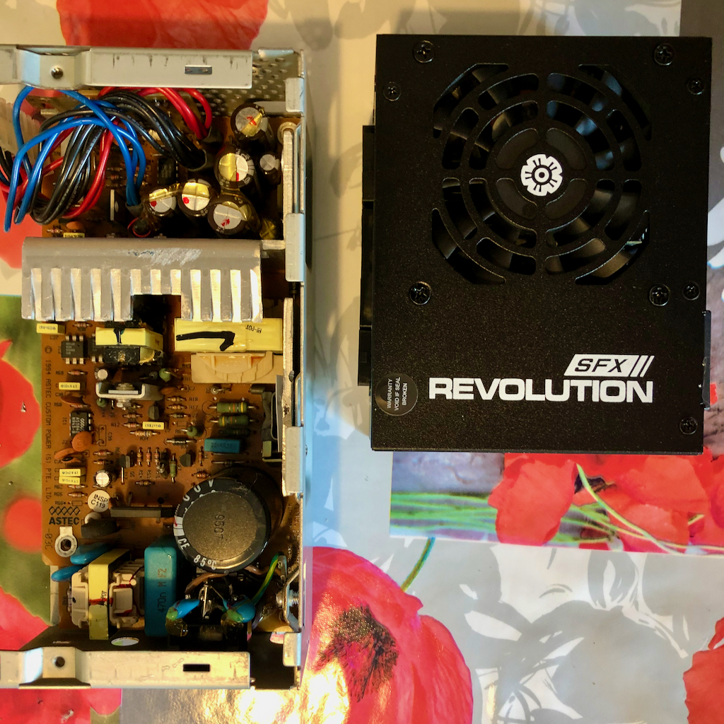

Now you can usually remove the old PSU. Here it is against the SFX PSU

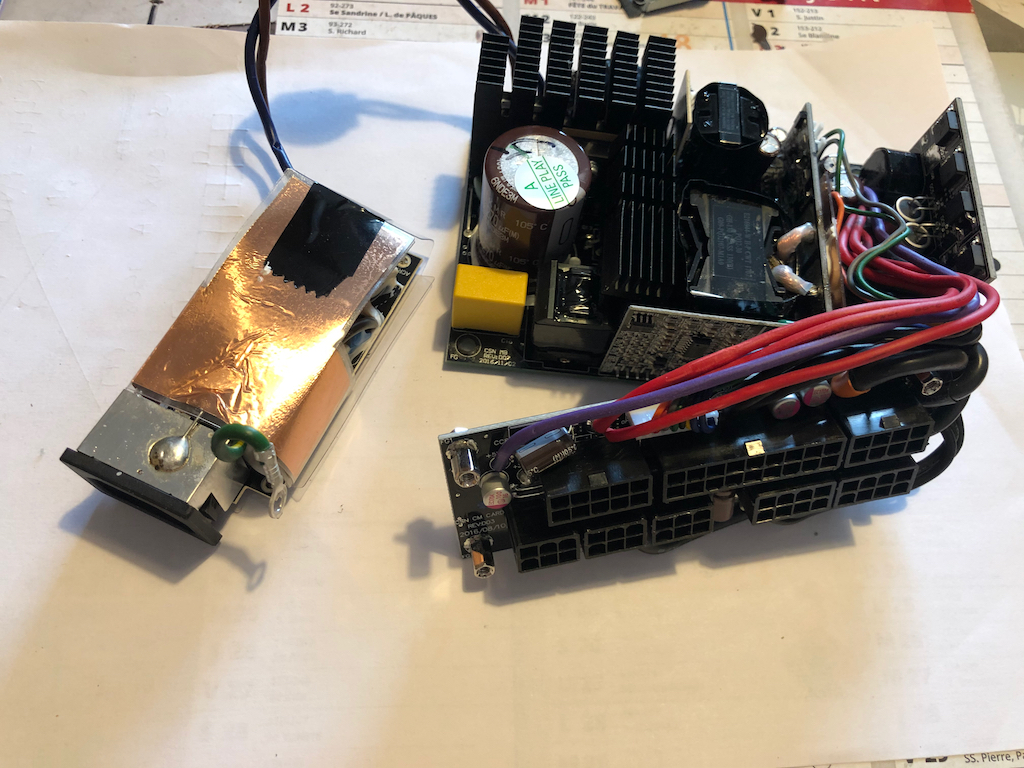

Remove the new PSU from its case :

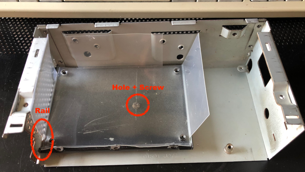

Cut the bottom of the case to it can fit inside the old PSU. You only need the plate on which the PCB is fixed. Secure it into the old PSU case. You need to drill a hole to reuse one or more of the old screws and use the rail which was previously used by the old PCB.
If your PSU has a power distribution board (like mine), remove it (cut the wires as close as possible from the PCB). I wanted to use it first, but it's really difficult inside this case.

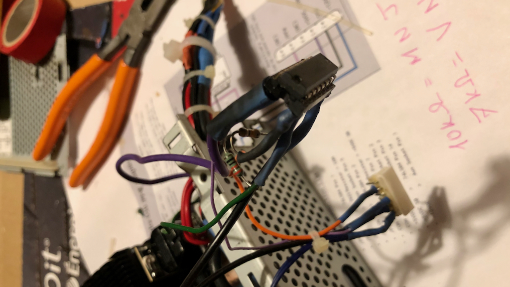

Build a boot signal concerter to convert the Mac Power Signal to the ATX one
You can use a PCB or make it redneck style. Please insulate the components with everything you can : electric tape, glue, heat shrink tubing, concrete, whatever.

Ha yes, sure, here they are. Same order as the original post.
Evaporated caps:
Overheating marks:
Old PSU (remove wires) from top:
Old PSU and donor PSU:
Connectors to harvest:
New PSU opened:
Cur new PSU plate into old PSU:
Pinout for Power Circuit:
Not that proud part:
