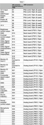

Hey! Thanks Chopsticks! Pretty good timing, I'm just now messing around with this again. Not sure about my notes from last time because indeed, all I have to do is connect id0 and id1 (s19 and s20) on the analog board 10p connection, and I get video out(!).@noglin i would expect that your video out issues are due to the fact that these machines need the monitor ID pins set so they display the correct resolution/frequency. S19, S20, S20, S21 need to get wired up correctly to get the right signal.
if you ground Sense 0 (Monitor ID 0, S20)to Ground (S21) you should get 640x480.
i haven't used the video mirroring board myself but i would assuming it still relies on the monitor Sense ID to be correctly set
assuming you have those pins configured along with the power rails and have inverted the power on signal you shouldn't need anything else wired up on the harness to get a bootable system (assuming you plug in an external scsi drive)
ive been a bit busy over the Christmas holidays but let me know if there's anything more i can help/clarify about what i did to get my setup working
However, I still need to connect the 10p neck-board cable, or else the video out signal (from the mirror-out) is distorted. The neck-board is not connected at all, except for this 10p. I tried to disconnect 1 pin by pin (breadboard cables betweem them), but all of them seem important to get clear video from the mirror-out.
The pin-out from takky for that 10p neck-board cable, has it as brightness and contrast control, r,g,b, -gnd, and rest gnd. I wonder if anyone has done any board to convert that directly to db-15/vga? (I think the performa 630 and 6200 has a video board that this cable connects to).
