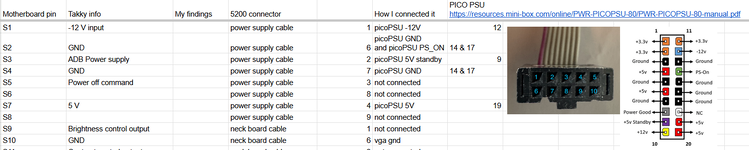

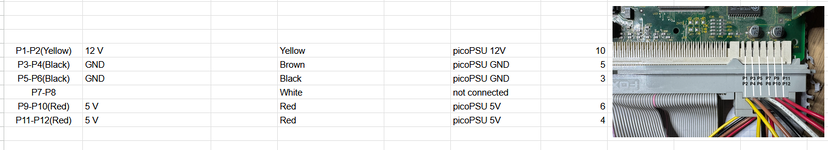

I redid the wiring, as I no longer got a screen-out and I took the chance to try improve the video.
I found hsync and vsync and used the original rgb signals and removed the mirror cable, I measured a bit more properly and found one ground that was dirty and left that one out. I got a cleaner video now - great!
However the audio jacket was no longer working. And I found I had done a mistake in the old wiring as well. So I also redid the power wiring, hoping it would fix the audio problem.
Instead it burnt an inductor on the motherboard. I have tripple checked and measured the power cables, and I don't see what I wired up incorrectly.
It would be much appreciated if anyone has some ideas what might have gone wrong:
One thing is that I only measure -1V where the pico PSU should give -12V, I did make a mistake and shorted the -12V with GND at one point, I don't know if this could have been the cause of the motherboard burning an inductor if it got too little though? This -12V is also very weak. The other pins on the PSU give correct readings.
I was going to post just the power connections here but the table did not display correctly. Adding as screenshot instead:
P.S. the motherboard was not connected when I did the mishap of shorting the ATX -12V with its ground.
