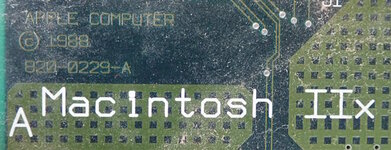

I recently purchased a Macintosh IIx that was listed as untested.Macintosh-IIx-PCB-label.jpg

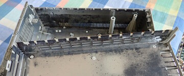

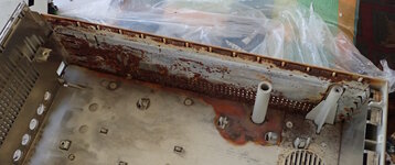

Unfortunately, one end of the case's metal shielding had a significant amount of rust. Since there wasn't a trail from the batteries or capacitors, I suspect the IIx was stored vertically in a location that experienced a spill or light flooding.
I usually treat rust with Evapo-Rust, but this is a really large object. They claim you can cover areas with soaked paper towels, but I haven't had any luck with that technique. I placed the IIx vertically at a slight angle to try to submerge as much as I could in a bin.
It worked well enough to remove all rust except for some brown stains in the plastic itself. If I had used numerous gallons of Evapo-Rust and had the patience to soak it for days, I'll bet the brown stains would have been removed. Still, it was good enough to clean the rust from the metal, leaving a black carbon coating. I treated the metal with Boeshield to leave a waxy protective barrier.

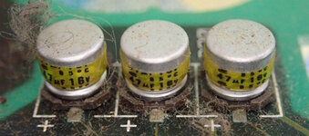

The PCB included early surface-mount capacitors with cool-looking yellow bands, rather than the value being printed atop the can.
Desoldering the old capacitors proved surprisingly stubborn. The cause ended up being TWO dots of glue holding them in place. Modern boards have no glue, whereas other Macintosh models have a single dot of glue.
The solution is to wiggle the brown plastic base of the capacitor to crack the glue. Don't grasp the metal can. The plastic base is not firmly attached to the can or the soldered leads. There is enough play that you can safely wiggle the base without putting stress on the traces or pads.
After freeing the base from the glue dots, desoldering is just as easy as an unglued capacitor. In the image below, look at that nasty adhesive ruining my day. Pads are fine.

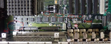

Despite adding the required fresh batteries, the computer would not power up using either the main power button or the ADB keyboard power button. Tracing the power line from the power supply connector, I deduced that UB1 and UB2 controlled the power signal.
After recapping and cleaning, I discovered a tiny trace disconnect on pin 13 (see image below). Yet, fixing that didn't solve the power problem.
These 74HC132 chips reminded me of something similar. On the IIci, these chips are almost always damaged, so I just replace them during recapping as a matter of habit.
I replaced both chips (they are off the shelf and cheap) by simply desoldering them with Chip Quick low-temperature solder. Basically, coat the leads with a generous amount of that type of solder. Because of the special low-melting point, it stays liquid for much longer than regular solder, permitting the chip to just float off the pads. No heat gun needed.
Still, that repair didn't get the computer to power up.
I began at the power switch and checked continuity on various vias and connection points on the under side of the board. A long trace connecting both the switch and the keyboard power had disintegrated. See the shiny long repaired line in the image below. What's weird is, the traces above and below it are fine.
Holy moley! There were at least five breaks between the switch and the power circuitry. All for that same trace. Nearby traces were healthy.
That's when it occurred to me. The power chips and trace to the switch were powered on when immersed in capacitor leakage. In an undesirable form of electrolysis, the battery power accelerates corrosion for components associated with standby / power up.
After carefully repairing the trace end-to-end, the computer powers up and passes testing with an external drive.

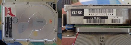

Sadly, the massive 5 1/4 Quantum Q280 hard drive was DOA.
On eBay, a seller named "our_drives_work" has 100% positive feedback for 6078 sales of legacy hard drives. This seems highly skeptical. For $25 plus another $25 for shipping, I replaced the drive with a Micropolis 1624. The drive was amazingly well packaged for safe arrival. I don't normally call out sellers, but it this seems like such an improbable business model for satisfaction, that I just have to mention how pleased I am.

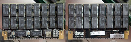

One solution is to somehow find PAL or GAL SIMMs which compensate for the /W line sequence. A GAL or PAL is usually a little square chip on the SIMM that looks different than the usual long memory chips. (Another solution is to build your own SIMMs with a logic gate to add a wee bit of delay to the /W line. There's a project posted on GitHub.)
I tried searching eBay for all combinations of keywords to find IIx compatible memory without any success. Weeks later, a listing in the middle of an unrelated search caught my eye. Someone was selling really tall (i.e. composite) 30 pin SIMMs that I could see a GAL on (can you spot it?). The presence of a GAL does not guarantee the SIMM will be compatible. I wasn't even sure these tall boys would physically fit.

I have a set of 4 of these SIMMs, is the part in the bottom right corner a GAL making these composite SIMMs? It's a TI16L8-10.
