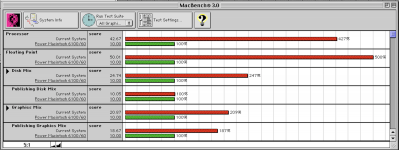

Benchmarks! Here are the results from MacBench and Speedometer respectively.
A mere 650 times the power of a Quadra 601... I am honestly amazed that this hard disk made it through the test and even got a good score. It sounds worse every time I boot the computer.
