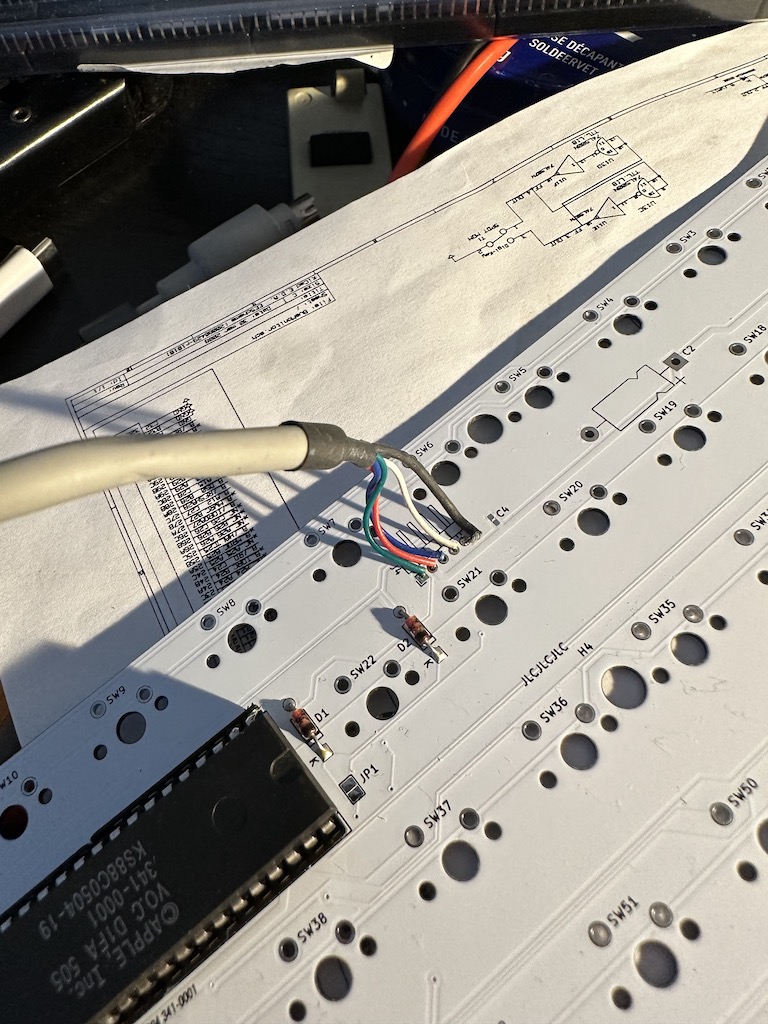

@demik , Can you provide details in the GitHub repo on the connections for the ADB wires. The wires labeled are GVAPE. In one of your pictures, it's not quite clear which color wire from and ADB cable goes where, but it appears maybe
G -green
V - red
A - blue
P - white
E - black
Is that correct if re-using the ADB cable from the donor Apple keyboard?
If you are reusing the old cable, the colours are indeed as follow:
I'm not 100% sure all cables are the same for everyone, so the letters stand for :
- G = ground (green)
- V = VCC / +5V (red)
- A = ADB (blue)
- P = Power Trickle (white)
- E = Earth / Shield (thick black)
