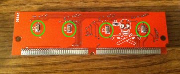

All the Flash chips have decoupling capacitors on the SIMM. The 10 uF capacitor is really close to the USB port and not too far from the AVR itself. No voltage regulator -- just takes the +5V directly from the USB port. A picture is worth a million words, so here's what I have:
The decoupling caps are circled in green and are 0.1uF. (the capacitor near the USB port in the pic above is not a decoupling cap -- it's a 1uF cap for the USB (3.3V?) regulator built into the AVR connected to the UCAP pin)
The cap in the pic above is the 10 uF capacitor I've been talking about.
Here are the decoupling caps on the SIMM for the flash chips. The PLCC sockets are on the other side.
Hmm It seems that you have plenty of caps where you need them. Here's a thought.
