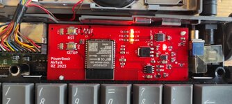

Good news! No inverted sockets this time, no fuming regulators... it works!
Here it is neatly installed in my powerbook 100:

I tried it with the case closed, and works too. One thing I did not think about is isolation since there are metal parts on top, for the moment I just went with some tape. Also some labels are reversed! oops!
I want to do some more tests later to see how performance it, it seems "normal" but I would like to test it more.
I also made a CDEV that reads the WIFI and STATUS lines (the yellow leds) but I'm not sure if it is really useful, as updating the CDEV is sloooow. There is also a button there connected to esp RESET which I need to fix (the pin is low and rst is acrive low, ooops2), and again I'm wondering if it is useful (it does have a reset button).

I did more tests, and it seems to work pretty well and seems quite stable. Do you know if there are tools I can use to measure network performance?
I mounted and tested a second one, and put it in my PowerBook 150, but it does not works :( Well, the module itself does seem to work, but LocalTalk refuses to switch to the modem port, so I cannot do anything. I will dig more into it, the 150 is quite different from the other 1xx and maybe it works on other models.
