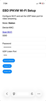

captive portal and wifi config is up and running, I'm on the brink of the first UDP packet based live video test, came up with an RLE compressed format that should be really easy to recieve and push into VLC for testing.

1 bit only, we're taking advantage of the simplicity of the video signalling and the fact they abused TTL logic circuitry to generate those signals, it's a weird simulated analog video signal that looks digital, you'd need at least 3x the processing power and memory to pull that off, you'd also need some complex circuitry to separate out sync pulses and such, it's just not worth it. these macs are the ones in most need of video output options and even deserve some remote control ADB peripheral replacement options that won't break the bank when added on top of video, this thing is gonna be a full IP based remote control if I can get the stack right. the name stands for "Everything But Disks, IPKVM"
