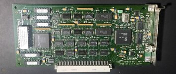

I got this SuperMac VideoSpigot card off @toples50 but looks like the card is not working. Do anybody have idea what could be wrong? The card is recognised by system and all extensions load correctly. When I first open ScreenPlay it shows a video for a second and then goes to blue screen. Everything else is working, the cables the video source is all the same and works with Rasterops 24STV card without problem.

I couldn't get mine to work with System 7. Supposidly if you put SpigotVDIG extension in the Extensions Folder it allows you to use other apps to play/capture video. Apple Video Player for one. If you take it out then the ScreenPlay App should work. That's how it worked on mine. I had better luck with System 6.0.8 though. I still used Quicktime 1.6.2 and ScreenPlay 1.2.2.

Are you running your monitor through internal graphics or a Nubus graphics card?
In the Q650 my Spigot works perfectly with internal graphics but it absolutely hates my BUG Pickles. After some faff with QuickTime I was able to get video input working but trying to record anything either results in a corrupt file or a complete system crash.
The ROM was an odd one, I could read it ok, but it failed the pin check in my EEPROM writer. I flashed a new one to be sure.
Have fun with it :)
