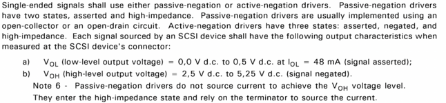

Let's be clear here . Here's a quotation from the draft of the ANSI/ISO SCSI-3 parallel interface standard for single-ended operation. (I don't have access to the final standard and I'm not buying it for the sake of this argument.)

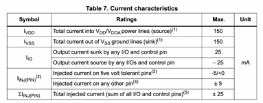

Let's look at the datasheet for a totally random STM32 part, under "Absolute Maximum Ratings":
Blue Pills are so variable that obviously there isn't a single datasheet for it, so this will do. Let's take the 48 mA per signal in the standard. Let's be nice to the BlueSCSI and pretend there are only 8 data lines, and let's also be charitable to BlueSCSI and say that the actual current is 24 mA. Even this wild standards- and reality-defying underestimate is 192 mA, well above the absolute maximum rating of this chip.
And don't forget, when they say absolute maximum, they mean it. That is the amount of current that can pass through the chip before it is actively damaged.
BlueSCSI works by luck and by guess, is strongly susceptible to variations in the Blue Pill boards used, and is nowhere near standards compliant.
