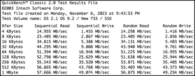

Here are some QB 4.0 results from a SiL3112 card with the EEPROM replaced & flashed, and with the voltage regulator changed - all in order to work in a Quicksilver. [Specs: 1.5 GB RAM, SiL3112, Netac 256 GB SSD and a 1GHz Sonnet ST CPU.] ¡Ay, caramba!

Yes @bigmessowires’ 750GB Crucial SSD sorta smokes my 128 GB Inland SSD + "Bribge" adapter in a similar Quicksilver running Mac OS 9.2.2 with QuickBench 2.0. (QB 2.0 and 4.0 do differ a little in reporting and then there’s also the difference between testing OS 9 and OS X.)
Too bad QuickBench 2.0 doesn’t provide those Standard Averages at the bottom like 4.0 does.
But still indicative of the relatively low cost & performance advantages of SSDs.
bigmessowires
My SSD is the Crucial (Micron) MX300 750GB, which I bought in 2016 and later removed from another computer. I wouldn't say it smokes the 128 GB SSD - the only place where they differ significantly is for small writes, otherwise the numbers are pretty comparable. I wonder if the difference in small write performance is actually the SSD, or if it's the SATA adapter, or OS 9. Are you able to boot into OS X and test it again?
