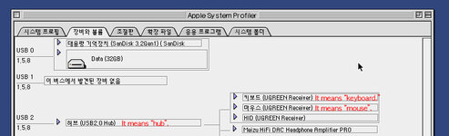

I posted yesterday, but it turns out I made a mistake. When I connected the USB receiver to the NEC USB card, it was only recognized as a "usbcompositedevice." As you can see in the first picture (my apologies for the Korean text), I then connected the receiver directly to the USB port on the Power Mac’s logic board. In that case, the System Profiler correctly identified it as a keyboard, mouse, and HID device. However, despite being recognized properly, the mouse does not work at all. Just in case, I installed USB Overdrive to check. While I still cannot move the cursor or perform clicks, the USB Overdrive app does recognize right-clicks whenever I try them. Unfortunately, it still does not function properly...
