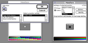

I then filled all the slots with VRAM and RAM, as well as an internal SCSI terminator. I am pleased to report that the Quadra is fully working again. The 2 MB of VRAM enables 1152x870 or millions of colors at 640x480.
