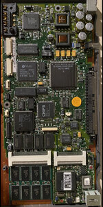

Right here :)
Don’t have photos yet for this one. I have a strange feeling that someone at some point may have sent one for the logic board that I just forgot about though…
I do have a photo of the board if you would like it. (280c and 280 use the same logic board)
3lectr1cPPC
You may have already sent one but I don’t remember… you’re welcome to send it again if that wouldn’t take too much of your time.
