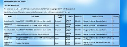

I'm curious to see if my 190 board will drive the Active Matrix panel/cable from a 5300c in my menagerie?
that is a good question, 5300c and 190 cs use a 10.4" display but the manufacturers and display cables may be different..
but it should be doable:
