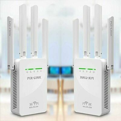

I use these with my old macs. They are cheap, nasty, low performance, but crucially are extremely basic on the ethernet side and play nicely with all my macs, even back to a Quadra 700 with a standard apple AAUI transceiver. I don't have any means of connecting anything older than that to ethernet to test.
Configure it in repeater mode and it works as a wifi-ethernet bridge.
