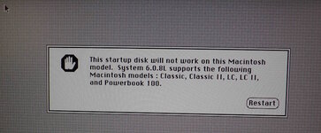

I'm working on restoring a PowerBook 100. While I waited for parts to arrive, I wondered whether the "limited" set of computers was artificial. Booting 6.0.8L on a Macintosh IIci displays this message:

Given that, and given that the appearance of the error message is similar to other crashes at startup, this means it is drawn by the SysError trap call.

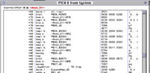

Upon breaking, I used the IP command to see a listing of the nearby instructions which I then searched for using Resourcerer. As you can see below, the code checks global variable $0CB3 for values <= 50 ($32) and for individual values of 4, 11, 13, and 17. If any of those tests fail, it calls SysError with code 102 ($66). An educated guess is that values one hundred and higher are negated and added to -20001 which would equal -20103 which is the string we found earlier.

Anyway, back to the patch. We simply replace the SysError calls with NOPs (no operation). This ignores the boot checks.
